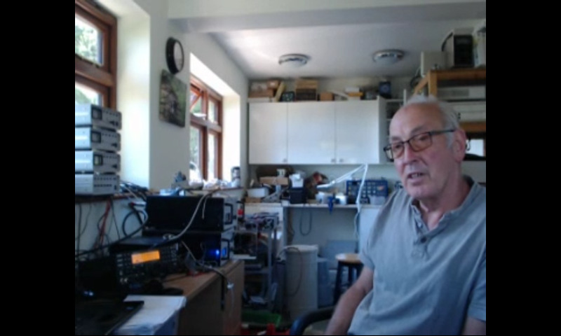

PS. Also worked Neil G4LDR on 5.7 GHz and 10 GHz - Screen capture below.
I think that this a new record for DATV on this band; Noel and I hope to increase this distance during the contest!
No PCs were used at either end. Portsdown with Lime transmitters, and Portsdown LongMynd recievers; it was great not having to mess around with laptops and mice.
- snap60.jpg (71.57 KiB) Viewed 6394 times
