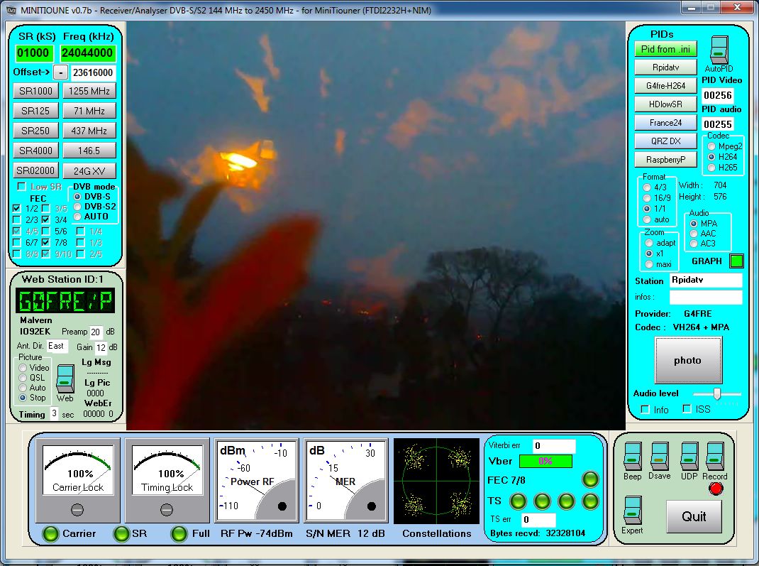

While out delivering the christmas presents to the midlands over christmas I got the opportunity to try my 24Ghz DATV system
The transmitter was at home in malvern io82uc with 2W to an 18"dish(PW) with a penny feed . The transverter is described at http://g4fre.com/24g_uk.htm and was driven by the portsdown on 70cm
The final receive location was at IO92EK, Corley moor, near the M6 Corley services 60km away from Malvern. The receiver was a DB6NT MKU245hp 2.5dB NF preamp through a bpf into a db6nt mixer into the Minitiouner. The LO was a db6nt xtal controlled unit. The dish was 2'
Pictures were surprisingly good and there is a few db in hand
By the time the system was setup it was getting dark so the h264 picture out of the G4FRE window (looking east across the Severn Valley) was a bit dark. The plant leaf was being highlighted by the red led on the camera, because as the camera was unboxed it had to be wedged in the plant leaves for support

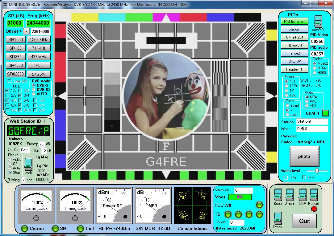

The transmitter was switched to mpeg2, at least it had callsign capability

h264 picture

mpeg picture
