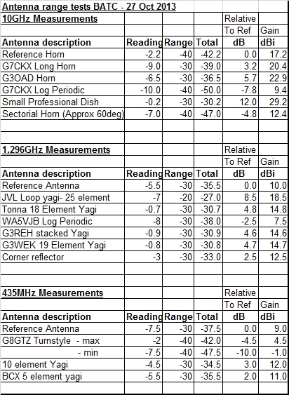

The range test results are in - big thanks to David and team for running the range in blustery conditions.
Looks my turnstile is not quite as omni-directional as I thought ;-( And the G2BCX 5 element yagi gives a surprising result considering it's length - time to dig out the old PW article and build one!
