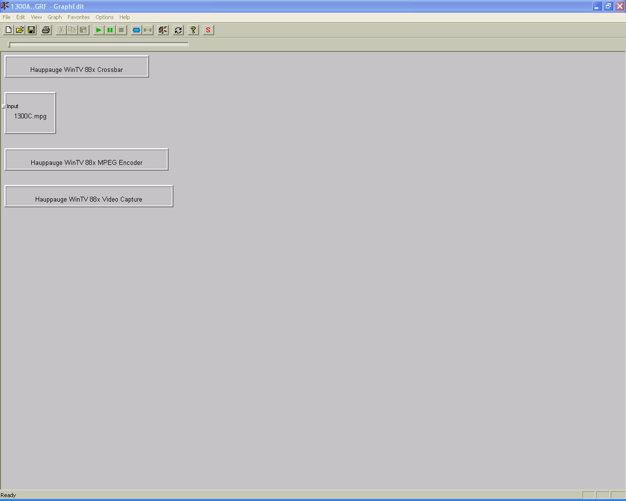

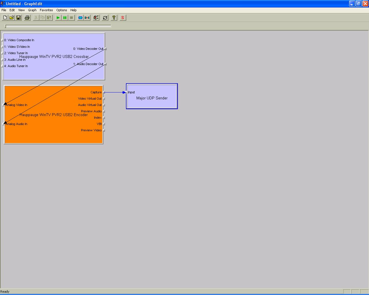

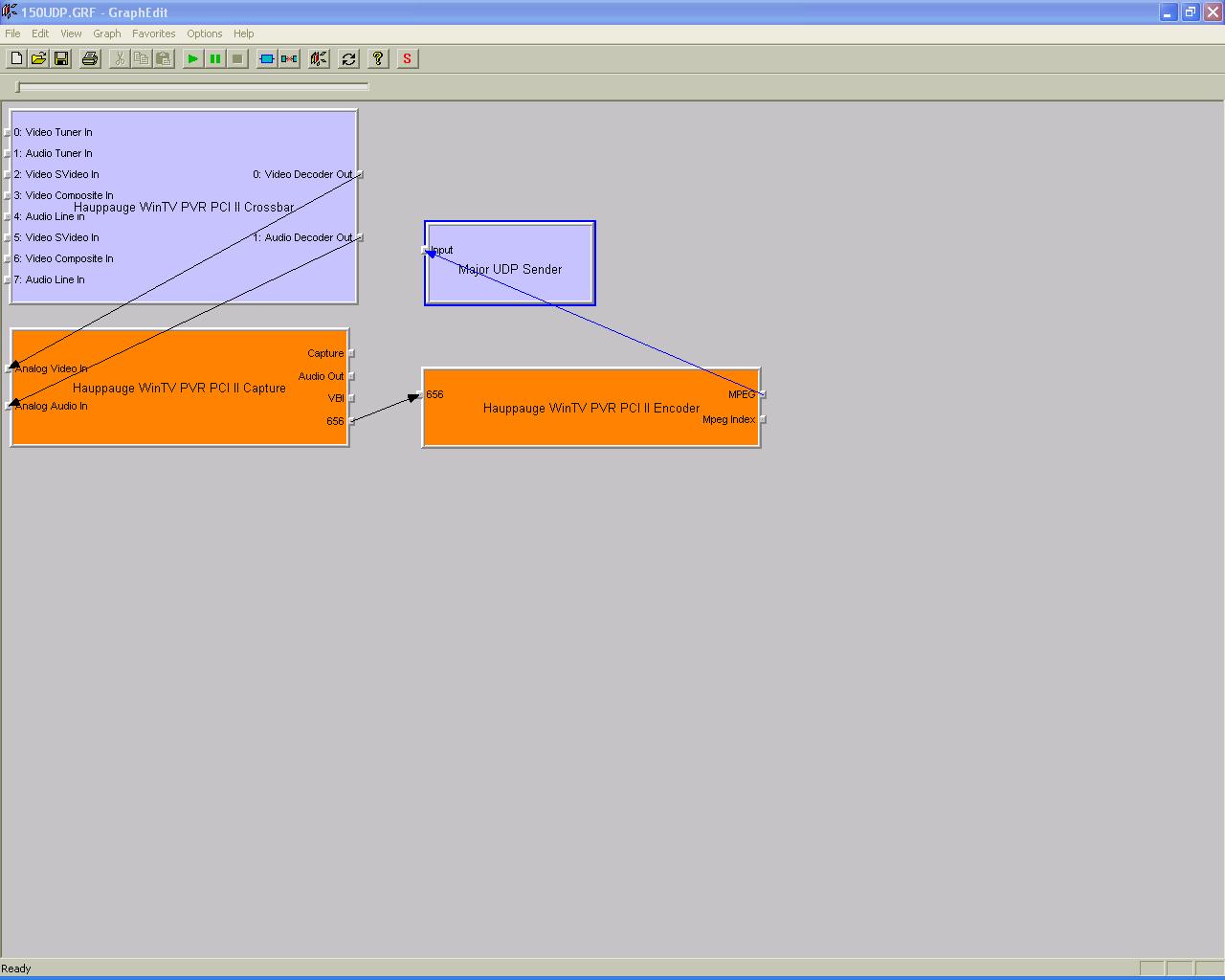

Re: DirectShow Filter graphs
Posted: Sun Dec 23, 2012 3:31 pm
by G4EWJ
I think the graphs for the 250/350 are the same as the USB2. I'll have to re-install the 1300 to see the pins on the filters.
Posted: Sun Dec 23, 2012 4:02 pm
by G4GUO
Thanks Brian,
That looks very much like the graph's I have but I don't have the Major UDP sender.
I will have a look to see if there is anything similar on my machine, there are hundreds of filters.
I tried taking the output (Program stream) of the Mpeg Encoder and rendering it but
I never managed to get anything to display. I did find a Google link for the PVR USB2
and that used a WintV renderer but I don't seem to have one of those!
Posted: Sun Dec 23, 2012 4:43 pm
by G4EWJ
The UDP sender is here:
http://www.majority.nl/files/majorudpsend.zip
I've never tried using filters within a program. I don't do C++ and I believe DirectShow is optimised for that. It does seem very messy.

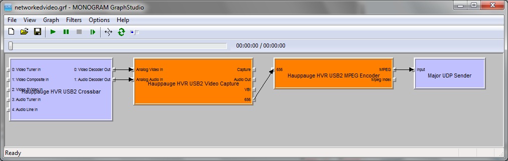

Posted: Wed Jan 02, 2013 12:44 pm
by G4EWJ
Very good. Can you post the graph for the HVR-1900 for future reference please.
Posted: Wed Jan 02, 2013 1:09 pm
by G4GUO
Certainly
