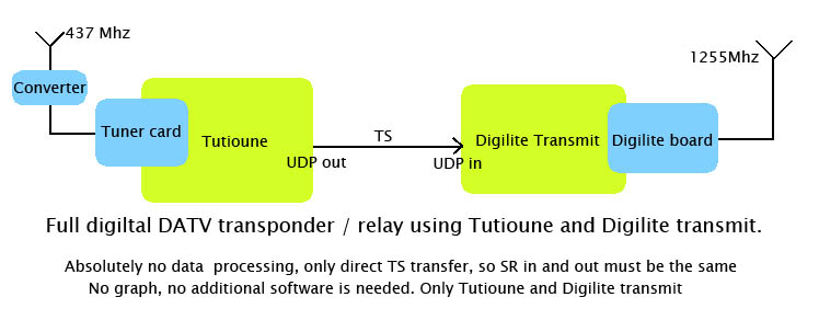

Yesterday we succeed to make a DATV transponder/relay, full digital, using Digilite and Tutioune.
Tutioune receive 437 Mhz via a converter 437--> 1337 Mhz and a Tuner card(TT S2 3200)
I just switch on the Tutioune UDP button.
Digilite transmit receive the stream and send it to the Digilite board on 1255 Mhz.
Absolutely no processing. very few delay in re-transmission as the stream is sent as soon as it is received by Tutioune.
the use is immediate for anyone that has already installed the 2 softwares : Tutioune and Digilite Transmit.
DATV transponder-1.jpg (56.66 KiB) Viewed 7054 times
We have made many tests yesterday, F5AG0 transmitting on 437Mhz, my Tutioune retransmitting on 1255Mhz to two others OM : F5UOU and F6FWZ.
(F6FWZ has no converter and no 437Mhz antenna, so it was the first time he could receive the F5AGO 437Mhz DATV signal.)
it could be done in reverse transponder : 1255Mhz input and 437 Mhz output.

I did something similar with GraphEdit and it worked well going from 1249MHz to 437MHz.
For simplicity and to keep the symbol rate and timing the same, maybe the padding packets on PID 8191 could be used to insert extra information. It would still be necessary to change the PAT and possibly the PMT. Perhaps the Tutioune screen could be coded as a digital subtitle and then the receiver could display it when requested. DigiLite has 5% of padding, so that's 400k bits per second at 4MS that could be used for something else.
I think some software to change the incoming PIDs to a standard set for output would be good. Several receivers, such as the Fortec Star 4000 and 4200 will not display a picture if the PIDs are different from when the original transmission was scanned.
Just to clarify, these experiments are being done with the UDP input to DL Transmit v2, which is still being tested and is not yet generally available.
