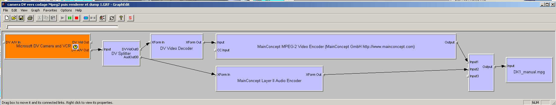

I have made a little graph to decode DV, Code video in Mpeg2 by software, code audio Mpeg1layer2 by software, mux them and send them to a file.
Digilite transmit take them immediately.
So we can use already today any video source we want.
No more need PVR150. ouf, I really don't like to use composite or Y/C input. Using Digilite was the thirst time I was obliged to use analog input to play DATV.
It's finished.
I no more need to use a PVR card to send real time video coming from DV camera, HDV camera, webcam HD (720p) or webcam 3D.
Just to use the graph I have created in 5 minutes and that I can reload immediately.

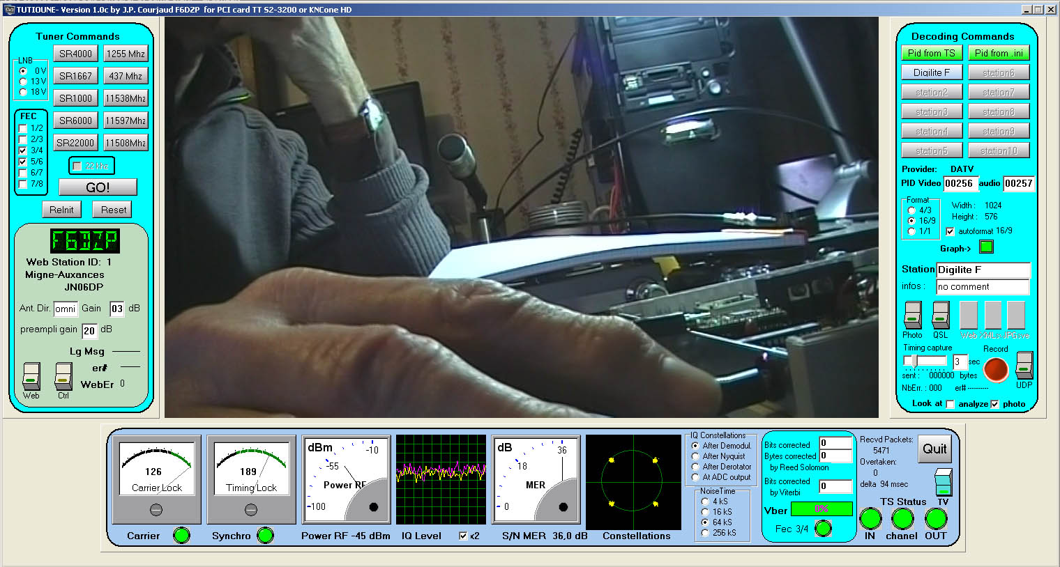

and Tutioune is happy to receive my DV signal in 16/9 format.
Tutioune read DV from Digilite.jpg (289.53 KiB) Viewed 15162 times
Youppy!! no more need of GB-PVR, no more need of PVR150 capture card if we want.

this morning I will send result using DV input to digilite , Tutioune receiver send pictures to my web monitor http://www.vivadatv.org/tutioune.php?om ... ation_id=1

What do you use as file writer?
the transmit program doesn't pick up my mpg file
i think because it is locked by graphedit while he is writing content to the file.
transmit program can't access the file at the same time.
how can i solve this?

I use GB-PVR Writer (GBPVRwriter.ax)
Yes we must need to use a Directshow filter that write a file and let it open for reading at same time.
I have found a second solution with the muxer writing itself the file, so in this case no more need of GB-PVR writer.

what muxer are you using then?
would it be difficult to build the graph in vb.net ?
that way we could make a stand alone program, instead of using the graphedit.

So today I tried to setup your implementation using a Sony DV DCR-TRV320E Digital8 camera, it uses Firewire interface. Can you I wonder tell me how or where to get the following filters - the MainConcept Layer II Audio Encoder, the 3 input one output filter and what actual filter to use for the DK1_manual.mpg file producer,is it still GBPVR Writer, I wonder. Or could I still use the UDP output stream I am currently using. I have the other filters sorted and linked.
As you probably have guessed I am a complete novice in building up Graphedit filter designs, so any help would be most useful.
