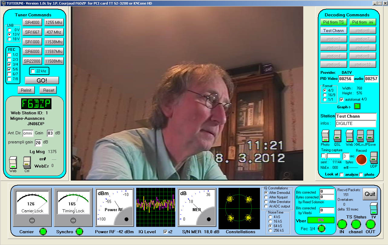

Firstly many thanks to all of you that have spend time for this wonderful tool.

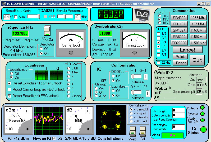

I have finished 2 days ago to build my Digilite board set on 437Mhz, 1MS - (I like very much this value using H264 coding with my others modulators)
The LO is the Ultram board set on 437 Mhz with its MMIC and the attenuator on Digilite Board.
I have a PVR150 in my PC and started to study it just before.
When I put the power to the Digilite board and used Tutioune to monitor the signal, I see very quickly the constellations and could tweak the trimmer to obtain 18db MER.
It's a really good value, knowing that DVB demodulator have much trouble to decode when Symbol rate is low.
digilte 437 -1MS HP8657B -3dBm Tutioune lite.jpg (238.71 KiB) Viewed 14349 times
Using Tutioune I can monitor constellations and MER and IQ level , Offset and Imbalance.
So no need of a spectrum analyser when all go well. I think Constellation and MER are one of the best tool to adjust all parameters. (But if you have more serious problem a spectrum analyser can help)
As I had seen several post that say that we must remove the ultram MMIC and the Digilite attenuator and also put the Ultram in a metal box.
I have done that and now the result is no so good : the 4 constellations clouds are now placed in a losange figure and MER is 14dB.
digilte 437 -1MS Tutioune without MMIC.jpg (491.51 KiB) Viewed 14349 times
I have tried also my HP8657B generator and Digilite board without input attenuator and I have observed:
HP RF level : -7dBm –6dBm –5dBm –4dBm –3dBm –2dBm –1dBm 0dBm 1dBm 2dBm
MER : 16dB 17dB 17.5dB 18dB 18dB 18dB 18dB 17.5dB 17dB 16dB
So in my situation, without attenuator, better values are with 437Mhz input from –4dBm to –1dBm
I will go back and put again the MMIC and attenuator on Digilite Board, results were the best.
Many things to say also about software, I will make a separate post.
digilte 437 -1MS HP8657B -3dBm Tutioune with video.jpg (296.67 KiB) Viewed 14349 times
Many many thanks, I ‘m very happy with that little magic board, and was very surprised that it worked as soon as I plugged 12v on it.

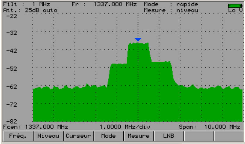

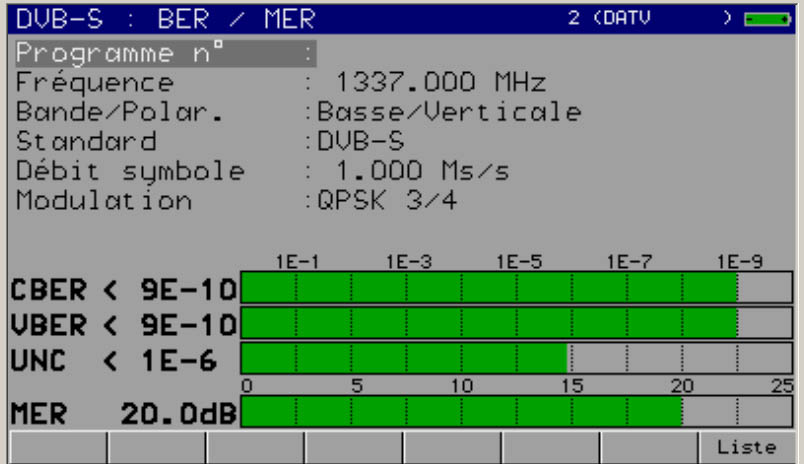

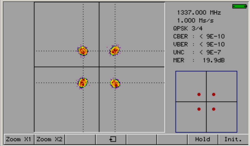

I have also made some measures with my SEFRAM 7856:
digilte 437 -1MS HP8657B -3dBm spectre.jpg (76.3 KiB) Viewed 14348 times
digilte 437 -1MS HP8657B -3dBm MER et VBER.jpg (84.85 KiB) Viewed 14348 times
digilte 437 -1MS HP8657B -3dBm constellations.jpg (64.55 KiB) Viewed 14348 times

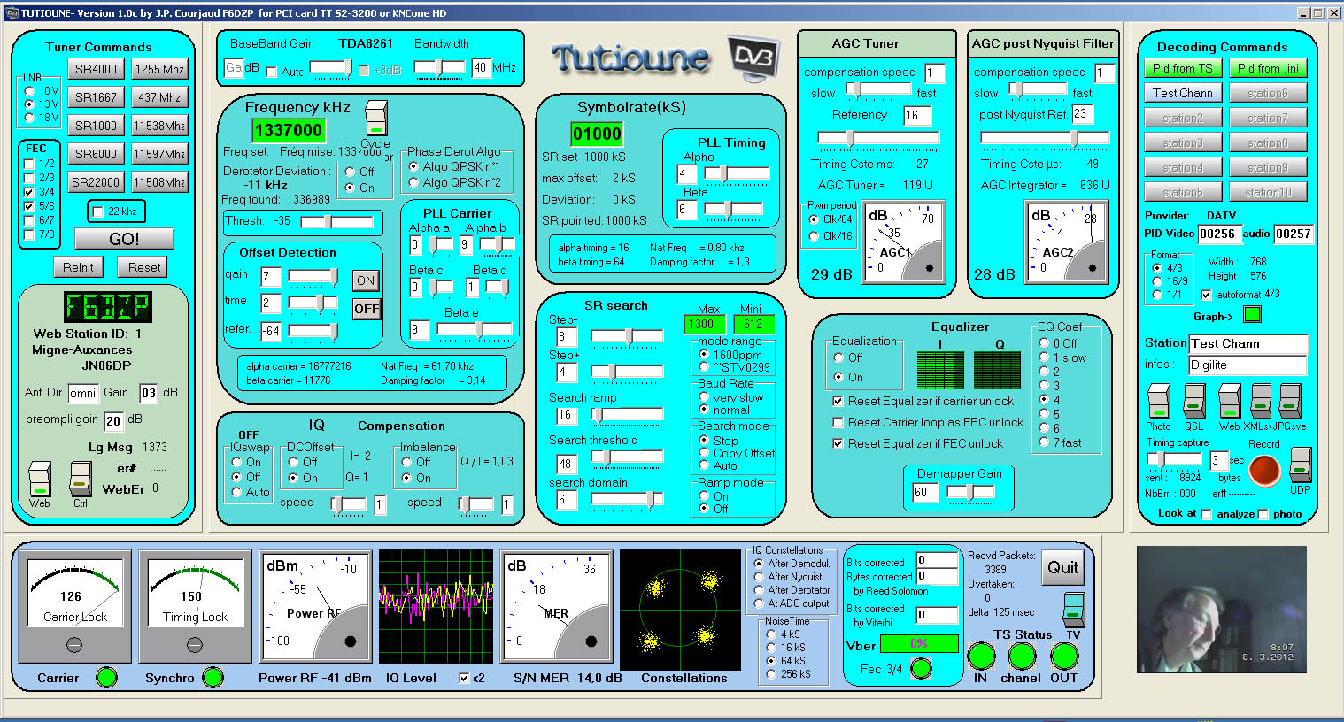

all my test in real time are on my Tioune Monitor:
http://www.vivadatv.org/tutioune.php?om ... ation_id=1

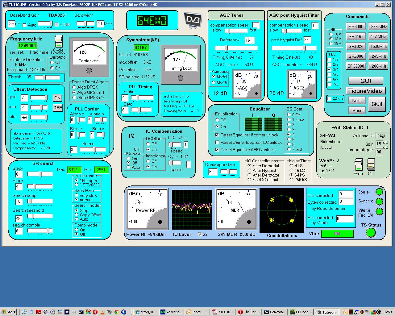

I wonder if your results would be the same on 23cm? The datasheet recommends -10dBm LO into the modulator, but others have found that increasing it to -6dBm reduces the noise. I am running with -6dBm at the input to the balun.

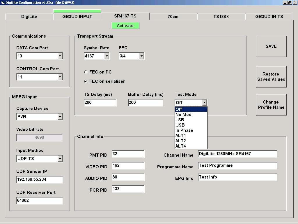

Here's a snapshot of a future version of DL Config. It has multiple profiles for different settings and bands, configurable PCR PID, extra test modes for toggling sidebands automatically and the UDP and TS input modes and IP / port settings.
I have only written software for a TS with exact bit rate. Adding padding would be more difficult. I would have to adjust all the PCRs, which would mean decoding the PAT and PMT to find where the PCRs are.
