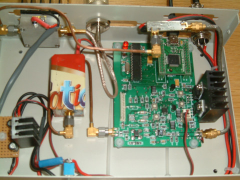

Use four 2.5mm bolts in the corners of the board.http://www.g8ajn.tv/dlproject3.htmlThey do not need to be electrically connected to the ground plane so nylon could be used if preferred.
G0KTD
Posts: 45
Joined: Wed Jun 08, 2011 7:39 am
Re: Mounting DigiLite board in enclosure?
Post by G0KTD » Sat Mar 24, 2012 5:47 pm
Hi all I have mounted mine with 4 3mm nylon stand offs and screws I think with the 5.7 board as the SMA input is located close
but should be able to drill quite close to the edge or near to the JP1.
Mine is the 5.6 board and is firm with only 3 in place.
Take a look at 4 point fixing.
