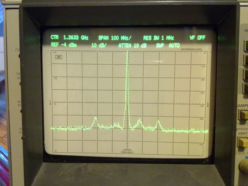

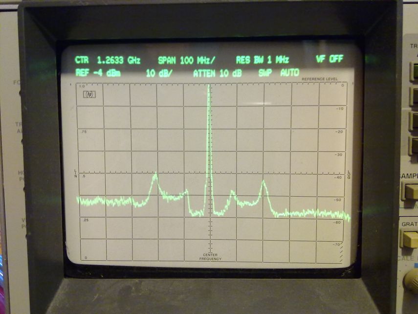

Here are some screen shots of the SA looking at the output of my v5.6 board with the onboard 12dB attenuator with reducing drive levels. Not pictured is the 10dBm as there appears to be a limit on the attachments; it's much the same as the OdBm but with further reduced noise 'bumps' at +/= 200MHz. Note how the output level drops when drive falls below 0dBm and the noise floor rises, particularly at +/- 200MHz where it only -35dBc, with -15dBm drive.
0dBm drive
-10dBm drive
-15dBm drive
There's clearly a need for a filter on the DigiLite board output. I've got a 3 pole 1/4 wave filter from an old RSGB handbook design that cleans it up but it's not that good despite being made from chunks of copper.

I don't use the Ultram vco myself, so I haven't seen the spike problem. Have you done the mod below?
http://www.batc.org.uk/forum/viewtopic. ... t=10#p2521
Could you do a plot at -6dBm injection please. That's probably what I'll aim for.
Just to clarify, the input levels you quote are at the modulator LO pins, taking into account the onboard attenuator?

That's right Fred, I am using the HP 8657B signal genrator to run the tests so the mod for the Ultram board doesn't apply. Please note that I changed the values of the input attenuator to give -12dB and a better match to 50R. (I used 1 x series 93R5 and 2 x parallel 82R5.) The original attenuator gives around -10dB.
With my Ultram producing +9.2dBm the level applied to the modulator chip should be around -6dBm allowing for the quoted 3dB insertion loss of the balun. The recommended level is from -6 to -12dBm.
However, looking at the design of the DigiLite oscillator input, I have to question the inclusion of the 50R load in the balun circuit; The datasheet says that the differential input of the chip is a good match to 50R (typically 1.9:1) and the test circuits shown all have the balun 'secondary' connected directly to ground and not via 50R. Guanella baluns don't need that resistor according to all references I've found on the net so that may skew the drive level to the AD8346 if you're trying to work from datasheet values.
With my 12dB attenuator in circuit the noise floor starts to rise noticeably when the input drops below 0dBm. That equates to -12dBm drive level without the attenuator so Brian's -6dBm should be good allowing for loss in the balun. The rate at which the noise floor rises is 2-3 times the decrease in local oscillator drive.
With regard to Alain's observed effect, I'm wondering whether his mod is increasing the drive level and that's fixing the noise bumps I've seen rather than being a defect in the Ultram oscillator. I've run 5 of the Ultram oscillators into my SA (3 @ 437MHz and 1 each @ 1249 and 1288MHz) and they are all within the claimed spec. for spurious outputs although some of the 70cm ones seem a lot better than others for close in sprogs. The second harmonic is quite high though, being only about -15dbC.
All the above does make me question whether it's wise to remove the MMIC on the Ultram board as has been suggested in this forum. It's supposed to have 22dB gain so without it I assume you will get -13dBm; apply that to the DigiLite board without the attenuator and include the balun loss and you end up with -16dBm which will definitely cause the noise floor to be higher than it should be.
