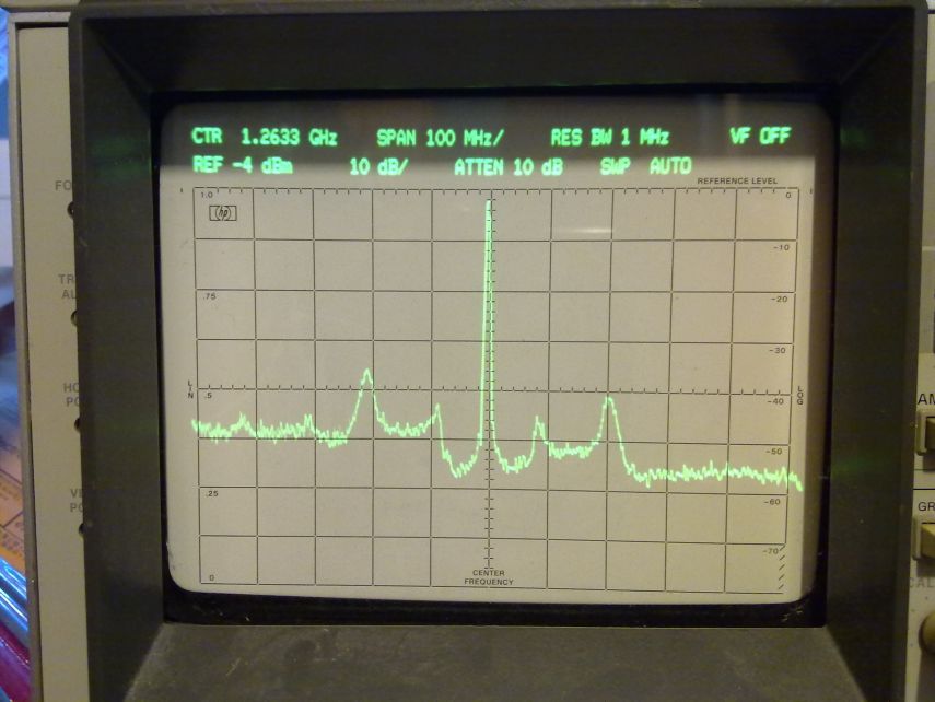

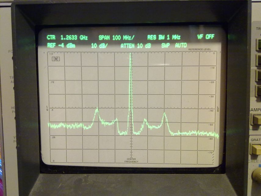

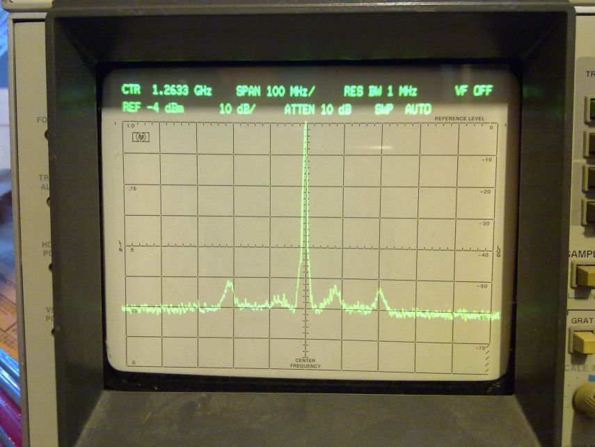

Here are some screen shots of the SA looking at the output of my v5.6 board with the onboard 12dB attenuator with reducing drive levels. Not pictured is the 10dBm as there appears to be a limit on the attachments; it's much the same as the OdBm but with further reduced noise 'bumps' at +/= 200MHz. Note how the output level drops when drive falls below 0dBm and the noise floor rises, particularly at +/- 200MHz where it only -35dBc, with -15dBm drive.

There's clearly a need for a filter on the DigiLite board output. I've got a 3 pole 1/4 wave filter from an old RSGB handbook design that cleans it up but it's not that good despite being made from chunks of copper.
