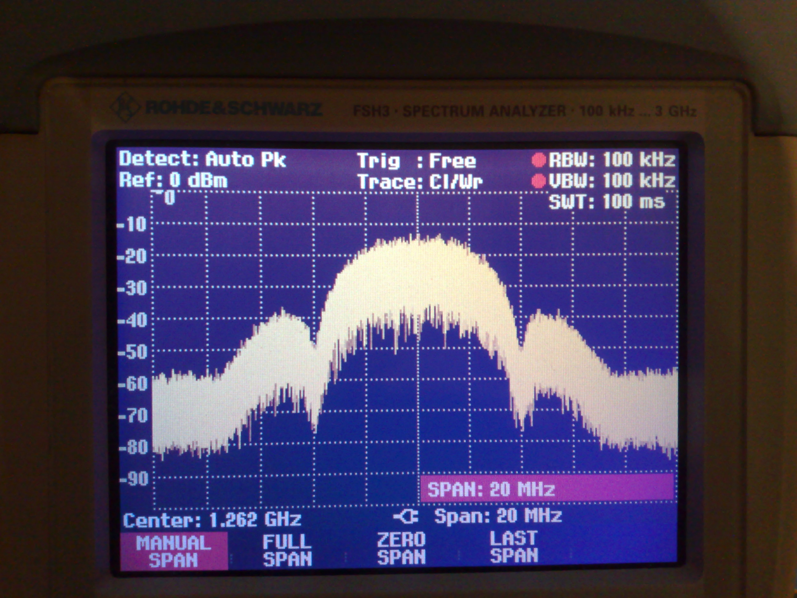

Post by g0uhy » Thu Dec 01, 2011 7:39 pm
v5.7 normal mod.jpg (650.12 KiB) Viewed 15244 times
the o/p of the DigiLite is very low, even with the MAR6 installed. You will probably have to use another couple of devices to give you a level which is ok for your PA i/p. A number of people are testing different devices with a view to produce a companion driver board, watch this space..hi.
I've attached a pic of the o/p of my DigiLite with MAR6 for comparison.
Malc
