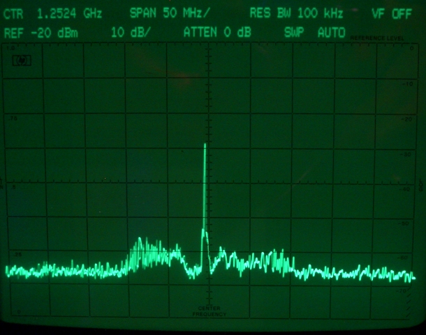

has anyone else experienced (like me!) some wideband noise either side of the TX frequency like the image below?
This was with both I and Q drive pots at minimum.
I cured it by replacing C22/C25 with 100nF, maybe be pickup from IQ drive on the board onto the bias supply.
Another note just to add is that you can use this: LMH6658MA opamp from Farnell ias a direct replacement for the AD828 at a significantly lower cost!

Thanks for both of those pieces of information. The better question is that would it hurt anything to make C22/C25 (or parallel the existing 1.2 nF) 100nF? I would guess not. This might be a good piece of advice for those who are building the units w/o a spectrum analyzer "just in case". The noise only looks to be about 30-32 dB down which is enough to want one to mitigate it.

Thanks for the tip, Rob. The noise is apparently coming from the TLE regulators, although on my Spectrum Analyser the noise readings appear to be much lower than those you are showing on your SA. Perhaps there may be manufacturers tolerances involved. It seems a wise precaution to include it so I have modified the circuit diagram and parts list accordingly. It may be too late to make the CQTV publication, but it is easy to piggyback a 0.1 across the existing 1n2pF.

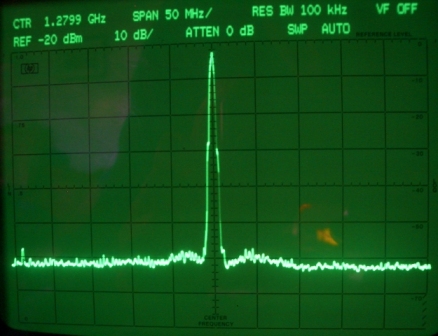

While building another board (v5.7) for Barry G4ZCN i thought i'd have another play with reducing the noise we have seen..
I've now got it pretty low now with even more decoupling, not quite right approach but it does the job!
Add 100nF directly at U3 from ground to output
Add 100nF across C12
Add an electrolytic of a few uF or more directly across Pin 20 to ground on IC1
The latter has the most effect so maybe having isolated Digital/Analogue grounds would be useful in the future.
Noise is now about 55dB down from Tx Level.

I'm surprised you needed an extra cap to U3 but not U4. Suggests some inductance in the track from U3 or variations in noise between samples of TLE2426.
I notice that there are not many vias between top and bottom grounds which could also be detrimental to noise.
By the way, it's not easy to see at 50MHz/ but looks like your sidebands are about 26dB down. Is that the best you have been able to get?

An extra cap on U4 does not help at all no.
The -26dB sidebands there are part of the 'bell' shape spectrum using the lumped component filter that is used on the Digilite, the real bits you need to be worried about are the sidebands outside these, you can just see them on my last image at ~55dB down but very close in.
On a system with a digital filtering like SR-Systems or AGAF you would not see the bell shape.
The noise i'm relating to is a 'hump' normally +/-50 to 100MHz from the main signal, hence the wide span, you can still see the noise 'humps' but they are a good 20dB down now from what i see with a standard build.
