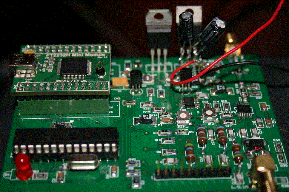

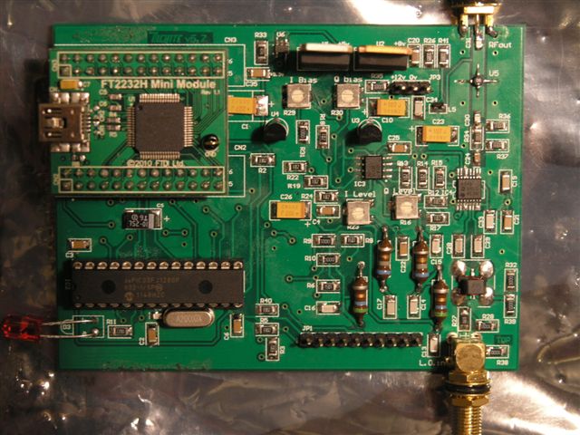

Just finished the last few bits and now ready for test....
Here is a few pics of the job so far....

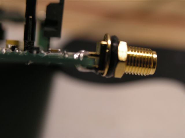

Best SMA for the output
digilite 025.jpg (24.36 KiB) Viewed 14791 times
Main Board V5.7
Main Board V5.7
digilite 023.jpg (81.21 KiB) Viewed 14791 times

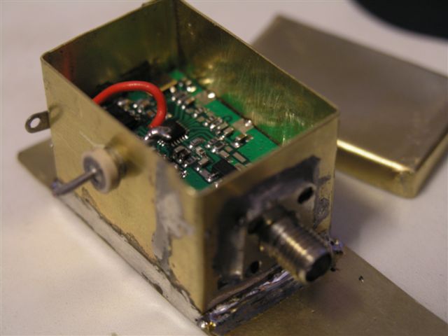

1249Mhz VCO
1249Mhz VCO
digilite 010.jpg (38.29 KiB) Viewed 14791 times

Looks excellent Chris, I can see what you mean about the sma socket, fits a lot better, the vco looks very tidy in the tinned box, good luck with the final test phase.

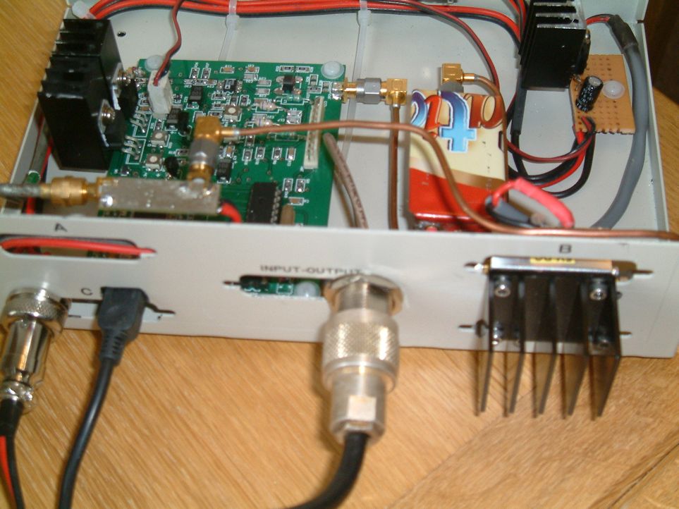

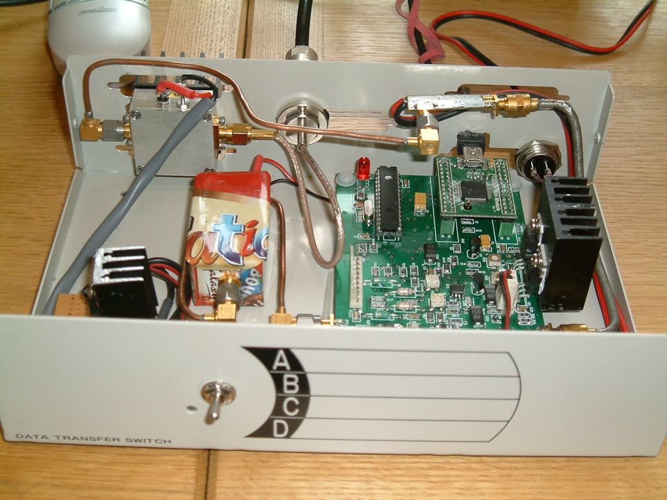

Hi all on the forum construction progress at this stage it has progresses from the wood board is was
mounted on to the box stage, have built mind into a old serial switcher box and it fit's in OK.
Have used a celebration's tin lid to make the 1249 VCO box and 1000pf feed through cap for supply still
have room for the VCO add on as when it is completed, and now to mount the Mitsubishi PA in the top
cover as this should be straight forward.
Now it has 2 watts of RF power using SPB-2026z pa, with the G4DDK SPF5043Z amplifier as a preamp
to drive the SPB-2026z.

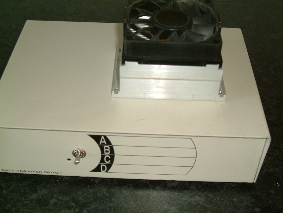

Now have fitted Amplifier to the top Cover
Only had to cut a hole and fix it down
