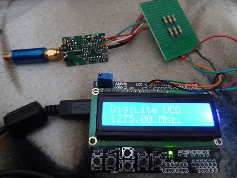

I have some sample code ready for the arduino.
With the up and down button you can change the freq in steps of 500 khz.
There are no boundaries for the freq at the moment.
start freq is 1250Mhz
Source is free to use and to adapt.
Menu has to be implemented...
Source code listing here:

I am curious about the ADF4351 board on the image. Could you tell me where to get one?
Thank you. Best regards.
Eduardo
Posts: 1527
Re: ULTRAM VCO
Post by G4EWJ » Tue Jul 02, 2013 3:48 pm
Eduardo,
The Ultram VCOs are available from the BATC shop. https://batc.org.uk/shop/hardware-and-kits
