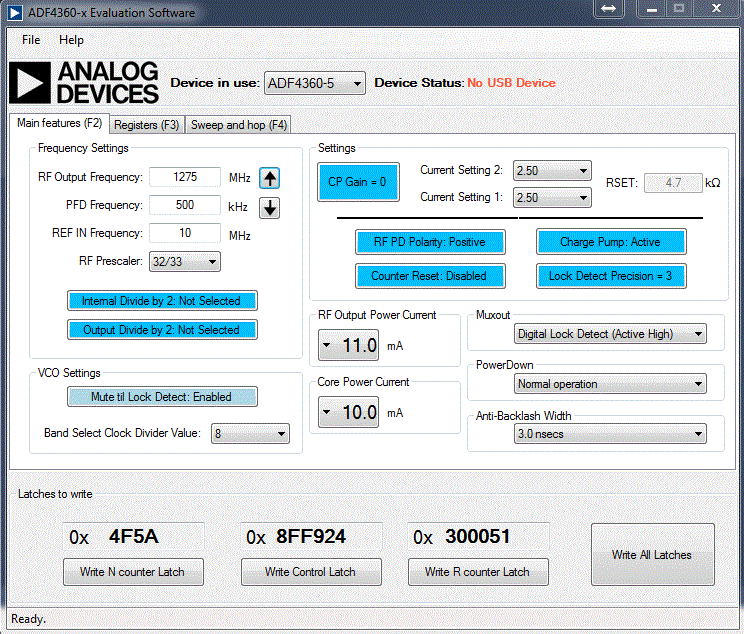

With this code: my freq is 1425Mhz:
#include <SPI.h>
const int slaveSelectPin = 10;
void setup() {
pinMode (slaveSelectPin, OUTPUT);
digitalWrite(slaveSelectPin,LOW);
SPI.setDataMode(SPI_MODE0);
SPI.setBitOrder(MSBFIRST);
SPI.setClockDivider(SPI_CLOCK_DIV128);
SPI.begin();
WriteADF(0x91,0x01,0x30); //R
delayMicroseconds(2500);
WriteADF(0x24,0xE9,0x8F); //Func
WriteADF(0x3A,0x8E,0x01); //N
SPI.end();
int WriteADF(byte a1, byte a2, byte a3) {
SPI.transfer(a1);
Toggle();
SPI.transfer(a2);
Toggle();
SPI.transfer(a3);
Toggle();
int Toggle() {
digitalWrite(slaveSelectPin,HIGH);
delayMicroseconds(1);
with the settings in the attached file, it will not work....
there must be something else wrong...
any ideas?

- ADF4360-5.GIF (107.17 KiB) Viewed 39138 times
Re: ULTRAM VCO
some latch combinations work, but do not give the right freq.
but most of them don't give any result on spectrum, others give me 3 carriers accros 0 and 2000 Mhz
a reset of the arduino always give me the same result. so at least it's stable....
i'm about to give up...
