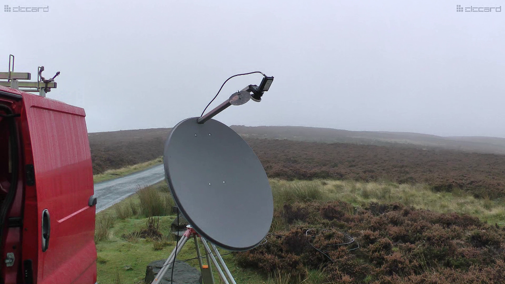

After some thought i gave in and decided to upgrade my pc ...hi
Now able to encode 1920x1080 60fps to mpeg2 PS at 8Mb/s for testing, encoding speed is about 2.2x.
Now i have a new question! you are using ffdshow encoder to generate the h.264 video stream, how do i change the output settings for this?, it has no CBR or VBR just a fixed bit rate setting.
I tried to get some video encode output but no luck using ffdshow, so i started to use the Elecard's AVC h.264 encoder. This works quite well here sending a TS to digilite and excellent video quality in 1920x1080! nearly as good as BBC HD
The only problem with the TS is that none of the muxers we have give us the DVB configuration settings, still nice to see it work.
Now to find an intensity pro HDMI capture card so i can use my HD camcorder as the video source.....
Rob - making some progress!
Snapshot below is 8Mb/s (6Ms 7/8) of MPEG2, h.264 quality is even better using 5.5Mb/s (4Ms 7/8) - both 1920x1080
