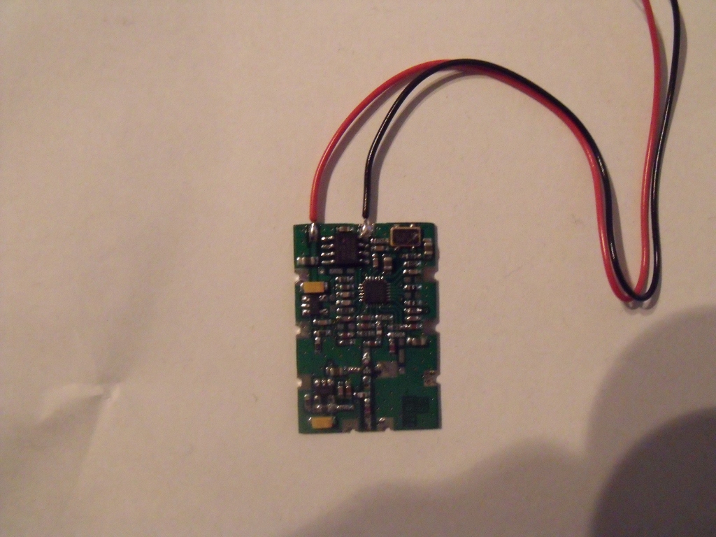

on what port do i connect the vcc?
on4bhm
on4bhm
Re: ULTRAM VCO
Hopefully the photo will show you how to connect the VCO. It runs on 6-9V.
