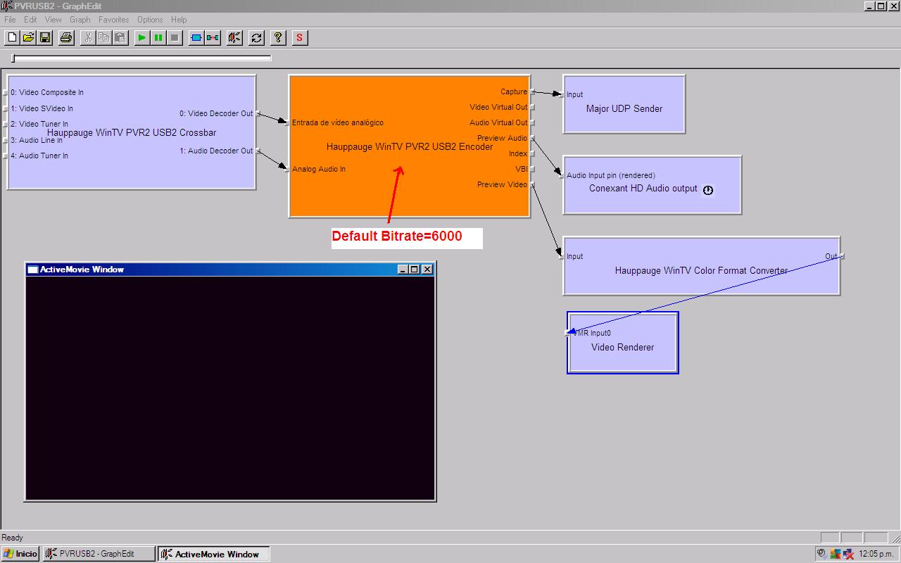

Hi all, sorry to revive this post, I bought a Hauppauge pvr-usb2 (sticker on the bottom 29032), I installed the driver on my laptop, and handling the transmission of Digilite with Graphedit, I attached my grapho by default the bitrate is 6000, however with graphedit I can not change the bitrate to 4490 needed to SR4000 3/4 FEC, every time I change the bitrate in the filter window, this change does not remain.
Anyone knows how I can adjust the bitrate, thanks in advance.

I've never had that problem. The graph must not be running when you change the video bitrate, but I think that applies to the PVR-150 too.
Can you change any other video or audio parameters?

Hi Brian, thanks for your answer, if possible additional settings, I change the audio settings and these remain,amplifier and video processor can also change.
I had installed the driver included on the cd, however I uninstalled with the tool HCWclear.exe, then install these driver Hauppauge website: http://hauppauge.lightpath.net/software ... _25022.zip
Now I can change the video bitrate, but when I close the graph, Graphedit forget settings, as you say it in your previous post.
in short, troubleshoot the video bitrate, but now I find that at the receiver the picture is jerky (small jumper) and the audio is choppy, pad is about 5%.
Josue

The pad% is good. I've never had a jumping problem with the PVR-USB2. I haven't used it for a while, so I'll set it up over the weekend and give it a run.
