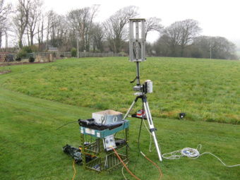

Hi all have been building Flat plate antenna's for Digilite portable use from G8GML, in conjunction with the artical in the CQ-TV 234
as in Cornwall we have a hilly county and alot of granite which adsorbs RF a great deal we have done 30 miles or so the one that
have been made so far on 1bay of 6 loops gain of 16 dbd and 2bay of 6 loops gain of 19 dbd others have made 4bay of 6 loop 22 dbd.
I have made 1bay and 2 bay version and all work well on analog and digital at the moment I have a 2 bay of 6 loops for my system.it works
fine power split-er of of Ebay Chinese manufacturer SWR 1.1to1
Normal size is 1bay 150x 600mm, mine are 1bay 230 x600mm 2bay 500x600mm.

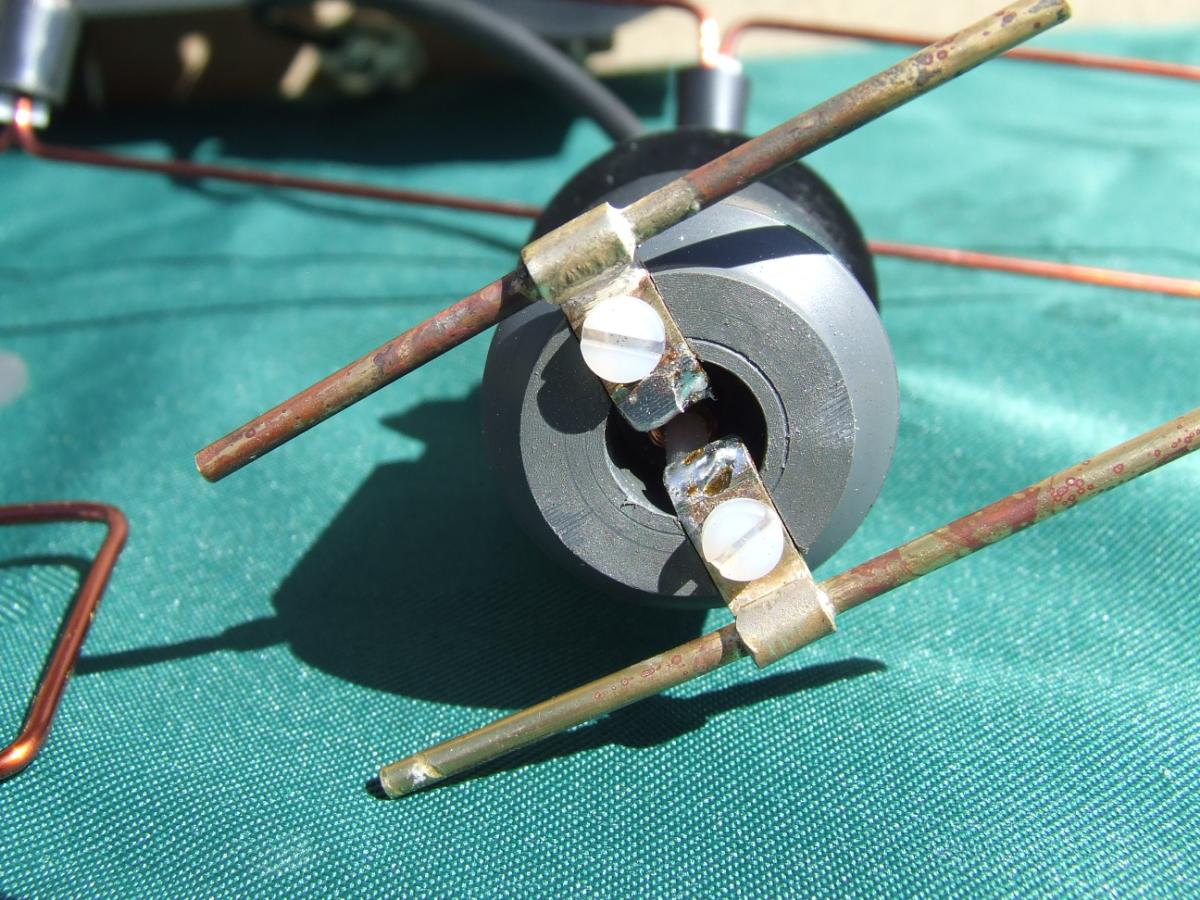

- Feed Point
- DSCF0986.JPG (171.48 KiB) Viewed 13069 times

Re: Antenna
This is the 1 Bay 6 loops I have for Portable use Tuned to 1249 for TX now making one for 1316 for RX
The feed point pic not that clear will take another later.

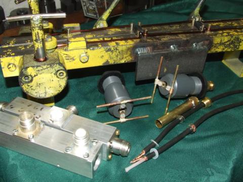

- The Element Jig for 1249 & 1316 and feed center and the copper Balun and coax cable

Re: Antenna
Hello Dick the feed point for the 6 loop antenna was designed by G3wkf as in the Batc CQ-TV 234 you can see the feed arrangement and up through the center is the Copper Balun which is 60mm long and is clamped to the screen of the coax this gives the necessary impedance to the 6 loops and the Trombone effect of the brass tube's is their so to adjust the loops in and out for the best SWR for the Freq you require all the other measurement are as the original Author.

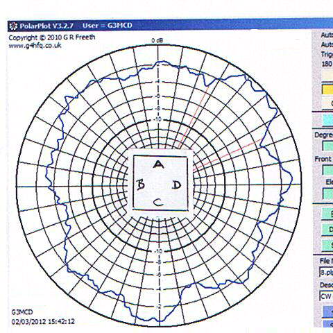

You wrote..."2. This I have not tried (I take it one plate 6 loop on the front and 6 loops on the back)"
What I was thinking originally was just two of the plates in the latern separated by 8 inches (as in your contruction...say plate-B and plate-D in the GB3NQ polar plot). I was originally wondering if there was a gain effect due to phasing between the two separated arrays. But I now realize that the screens act as a ground plane and prevents the two arrays from interacting like a 2-element beam. So, as I see it now, if I had a two-plate array as I was envisioning, one plate would beam to the east and the opposite plate would beam to the west.
I do like 4-plate latern approach you are using...a very nice gain omni-directional antenna.
