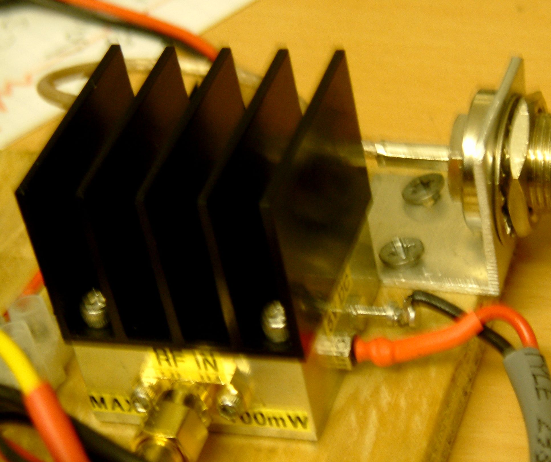

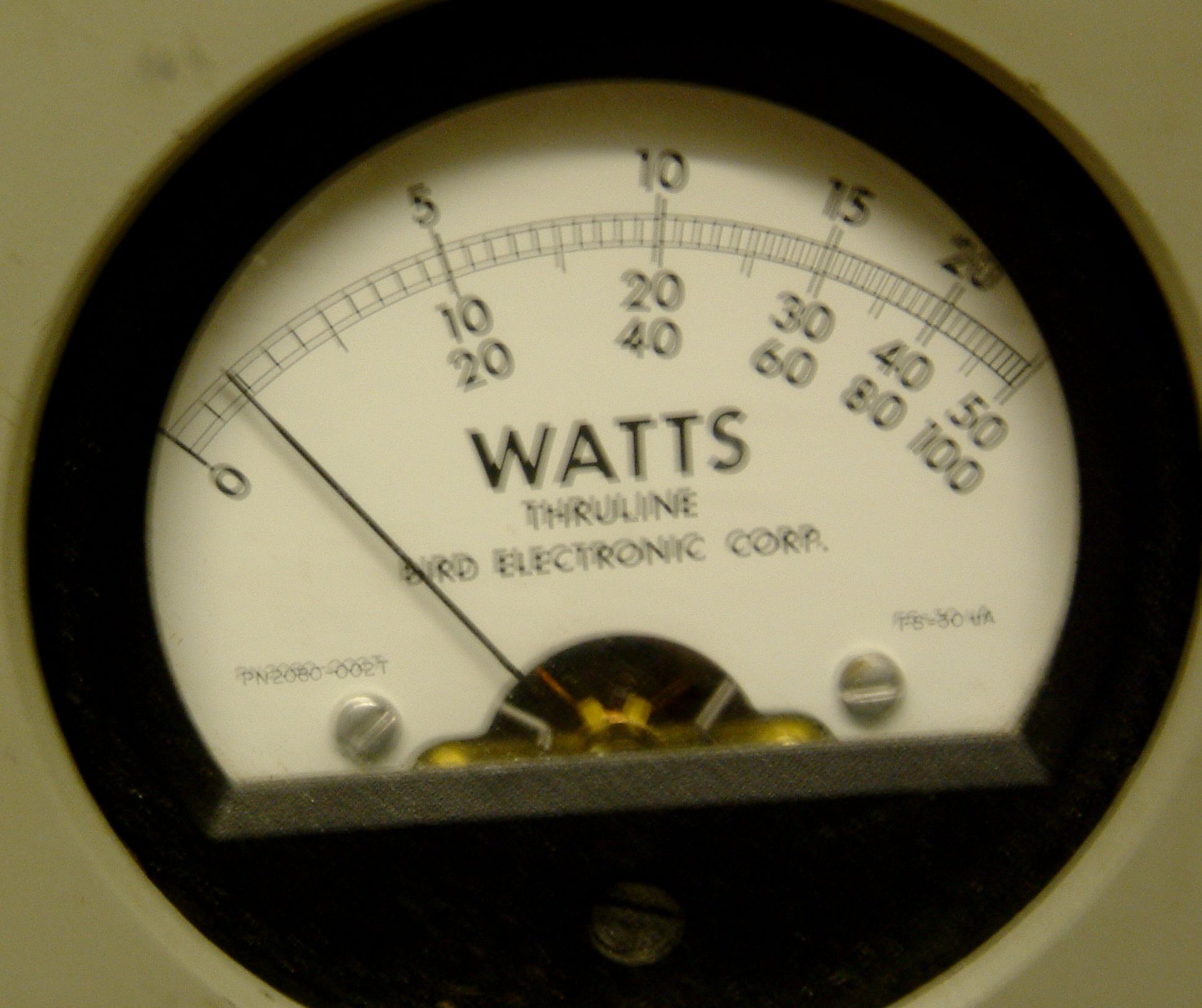

Post by G0KTD » Thu Feb 16, 2012 3:14 pm
Amp
Amp
2watt amp.jpg (305.61 KiB) Viewed 6357 times
almost 2 watts
almost 2 watts
2 Watts.jpg (285.02 KiB) Viewed 6357 times
I have one giving 2Watts out it was put together by G4KLB Colin as is was a bit small for me to do he built it with a hot air gun on the device as this is a bit tricky to do with a soldering iron
The Scart Group is working on a design for one as well look at GB3SQ NET ON SUNDAY
Keith G0KTD
