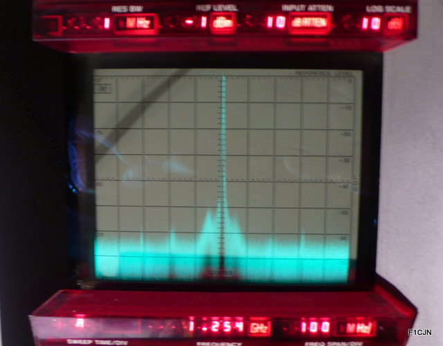

This is my output spectrum with the decoupling caps on the regulators and video, plus the 68pF capacitor on the V+ supply of the O/P voltage stage of the Ultram VCO.
Alain
F1CJN
Alain
F1CJN
- Digilite Spectrum
- Digilite_spectrum.JPG (89.19 KiB) Viewed 9194 times
Re: TX Noise
Hi Alain,
It looks very similar to mine just you have better dynamic range to see the noise!
is that with Carrier only or running with Data?
