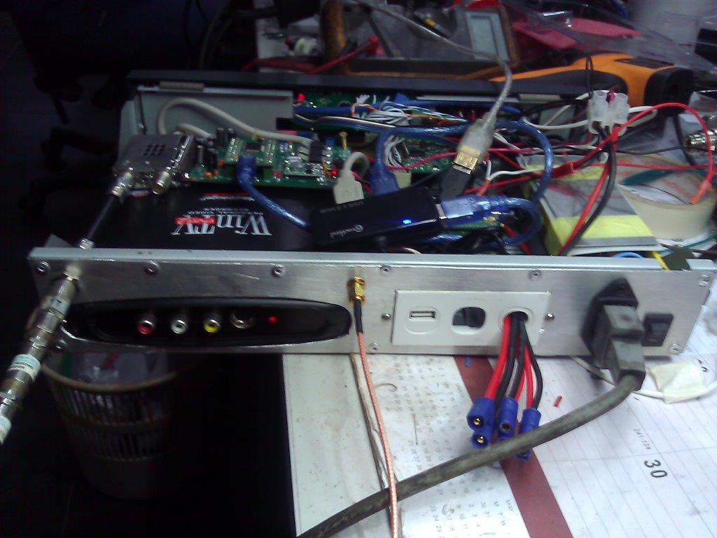

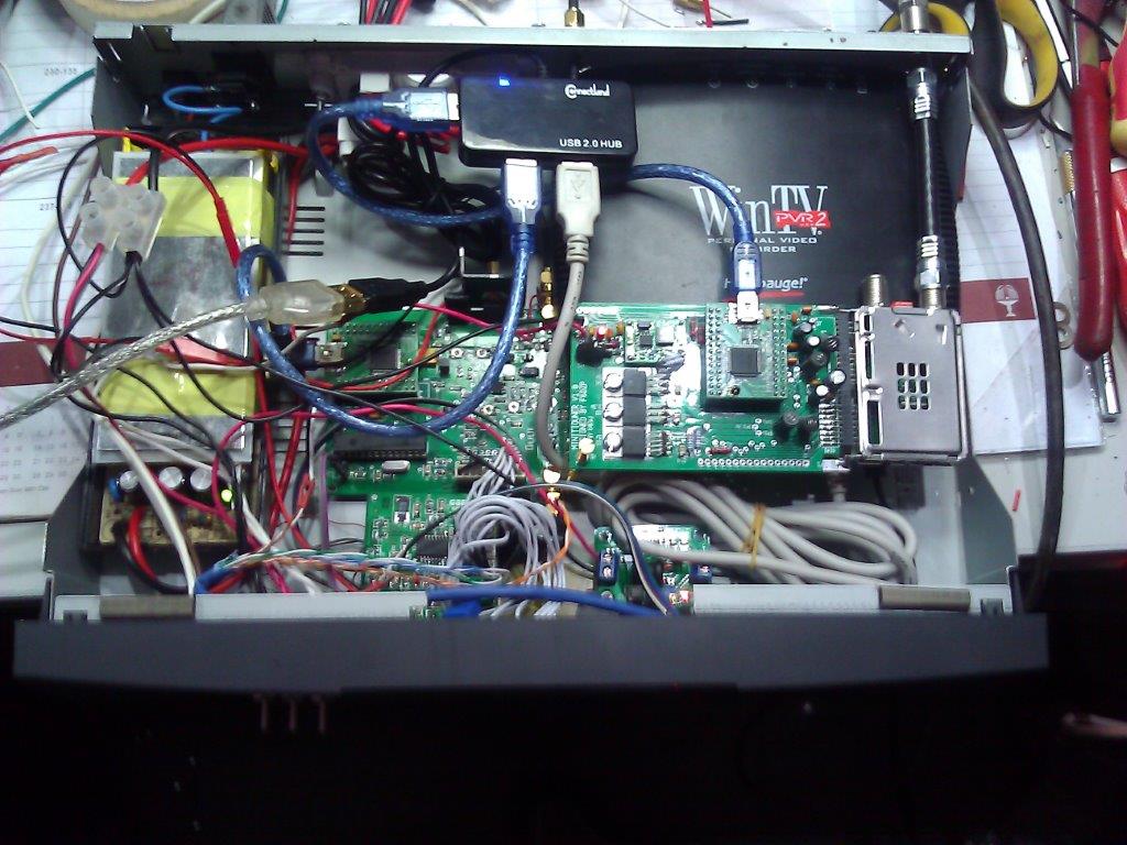

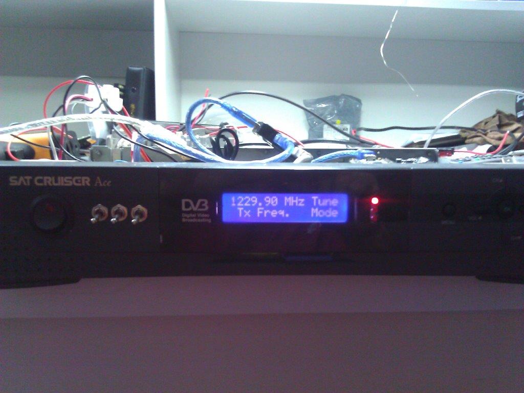

Digitiouner
Well Digilite, Ultram with controller, Mini Tiouner and PVR are all in one box: an old Sat Box I call it "Digitiouner"
A cheap USB hub splits the USB 3 ways they all seem happy with that
It's a bit of a squeeze, the RF amplifier will be outboard as that generates heat but is feed from the 8 Amp inboard supply
The Ultram didn't like any thing close by so we jiggled a few bits around
Now it just needs a tidy up
- In loop back mode for testing
- WP_000697.jpg (97.79 KiB) Viewed 23896 times
- It needs a little tidy up
- WP_000695.jpg (130.65 KiB) Viewed 23896 times
- Digitiouner
- WP_000694.jpg (82.28 KiB) Viewed 23896 times
