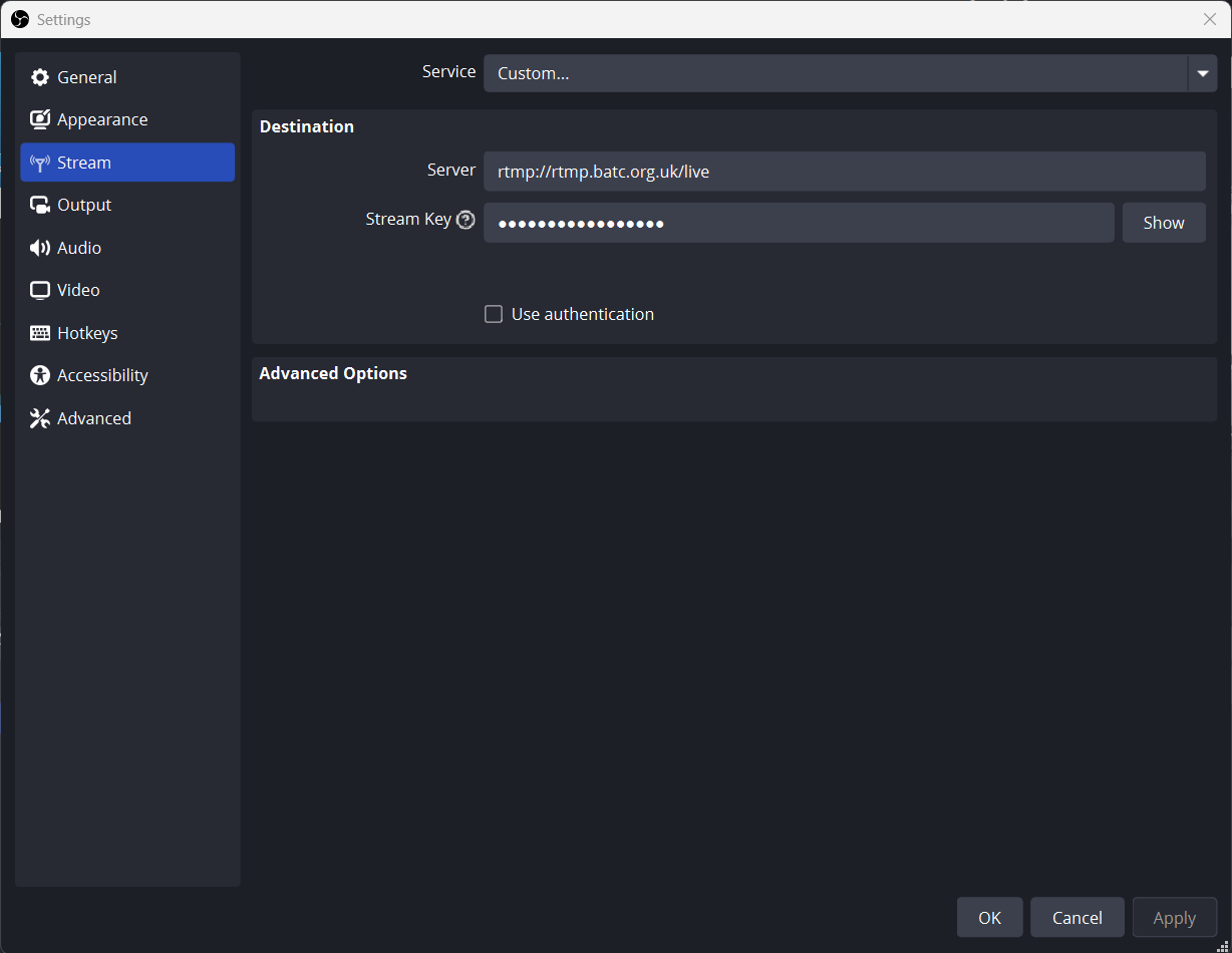

I still have a question regarding streaming. I was able to get my streaming details from my account. I filled it out correctly but when I try to stream with OBS my pc says. quote cannot not open specified channel or stream key. Possibility channel or key not valid. Or server thinks that I am still online.
Who can tell me what i am doing wrong?

Post an image - but without showing the key - of the OBS stream setting. Should look like:
Screenshot 2025-04-09 164831.png (41.15 KiB) Viewed 8050 times
That.
stream key will be of the form VK3HKS-xxxxxx with xxxxxx replaced with your key obviously - and it might be lower case - depends how it is set in the dashboard.

Hi there here is apicture of my detailsImage
Re: streaming to batc
Posted: Wed Apr 09, 2025 6:24 pm
by g0mjw
Your streamkey looks too short
