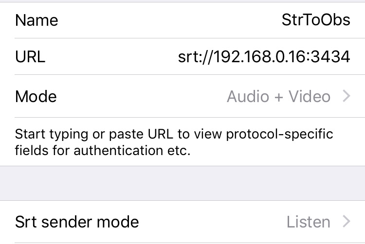

Just to add : I found srt protocol much better to stream between my smartphone and OBS (using my phone as a camera). In addition it streams also HEVC protocol, rtmp does not.
I use the Larix application
Hereafter two pictures showing my configuration, one on the phone (Larix), the other on OBS (Media source)
IOs config.JPG (58.26 KiB) Viewed 15181 times

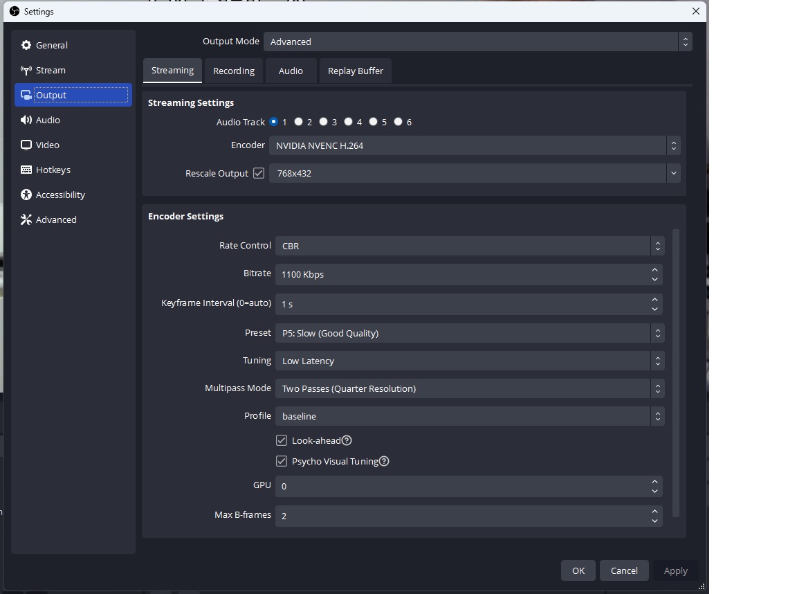

when I started testing yesterday, I didn't get a picture at first. Until I noticed that it sometimes took 30 seconds for a video to be displayed.
In the meantime I've played around with the settings and the picture is there within a second - here within the home network.
Here are my output settings:
