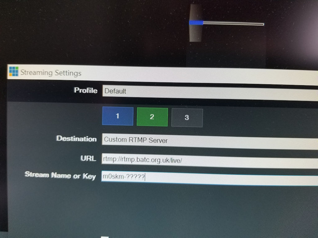

This is the entry in my vMix. Is this the same view you have? Mine is the full paid HD version.
- rs20200617_161611.jpg (113.21 KiB) Viewed 11413 times

That's exactly what I have and the streamer used to work fine. I've put it to exactly like you said and I've also got the paid for version.
At least with your help I've got further.
so thanks for that.

Re: VMIX Streaming
Glen
You have 2 items double-entered. The last line of the ffmpeg error report says that it is trying to stream to:
The address it should be trying to stream to is:
Details here on the Wiki: https://wiki.batc.org.uk/Configuring_yo ... _input_URL
Code: Select all
rtmp://G7MNP:******@rtmp.batc.org.uk/live/g7mnp/g7mnp-######Code: Select all
rtmp://rtmp.batc.org.uk/live/g7mnp-######Dave, G8GKQ
