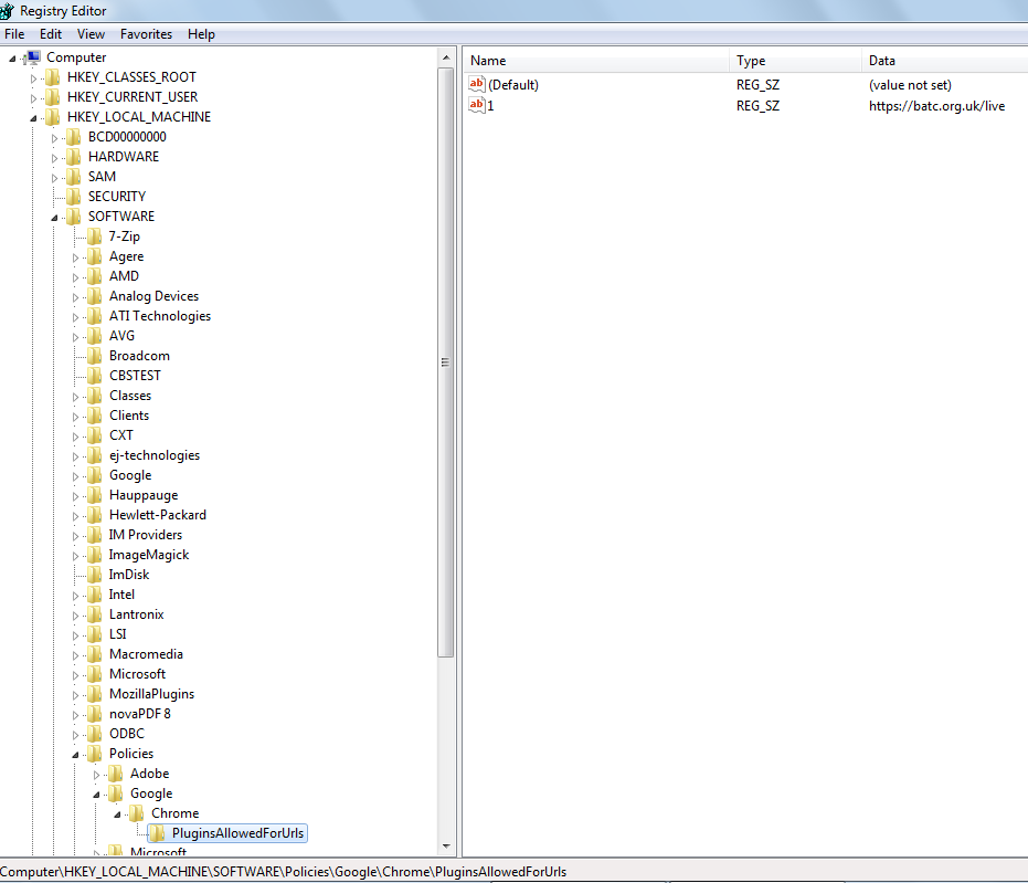

Posted: Thu Dec 20, 2018 11:55 pm
by G4EWJ
This seems to work. It probably enables more than Flash, so user beware.
Look for "Yoda Jedi Master said" on 8 Dec. Run REGEDIT as Administrator.
https://productforums.google.com/forum/ ... BgK90LUk7g
