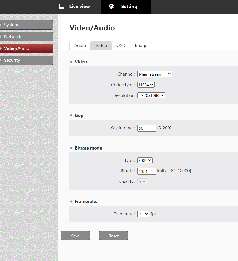

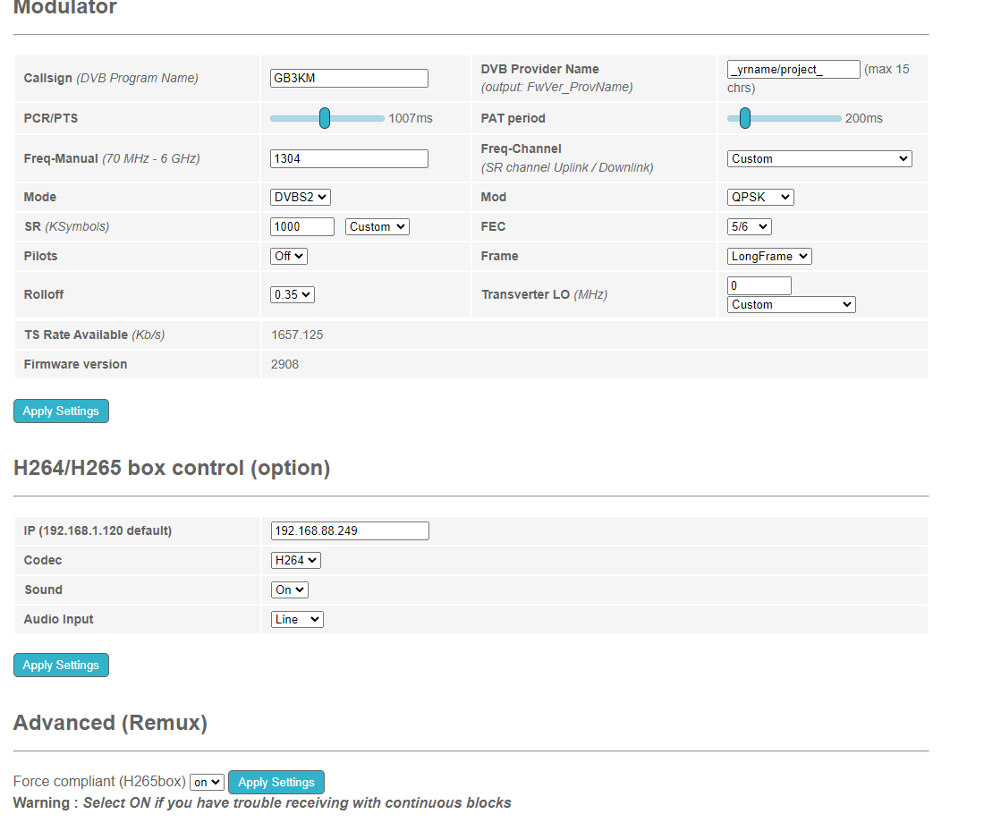

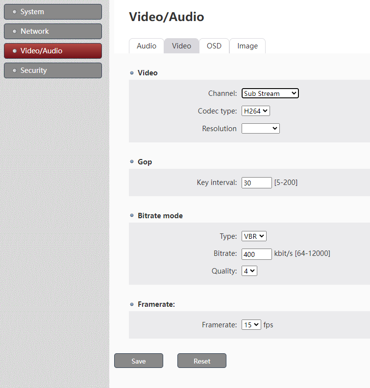

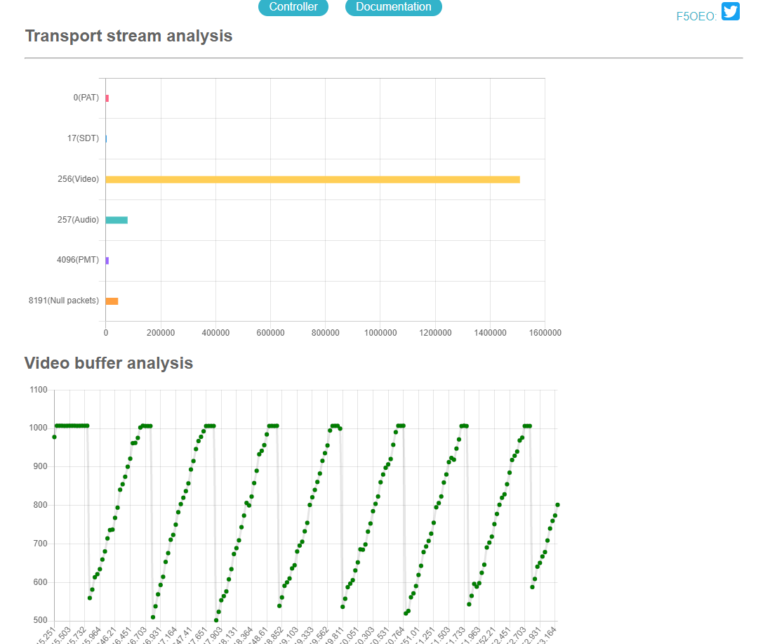

Here's some screenshots of the pluto/encoder settings i'm using for KM.
I've forced the second stream to 1280x720 manually hence it shows blank on the encoder status page.
Trick is to keep the sawtooth pattern in the pluto analysis page above zero - increase PCR/PTS if it's getting close.
It is always a battle against latency vs stability, i'm getting about 2seconds latency with the current setup when received on a STB, it's about 2.5-3 seconds when using minitioune or Ryde.
I would like to try the link-pi encoder but can't really warrant spending that money on yet another encoder that may sit on the shelf with the others!
I don't use the current Chinese boxes i have here now as PC encoding is far superior.
The PC does use WAY more electricity though!
