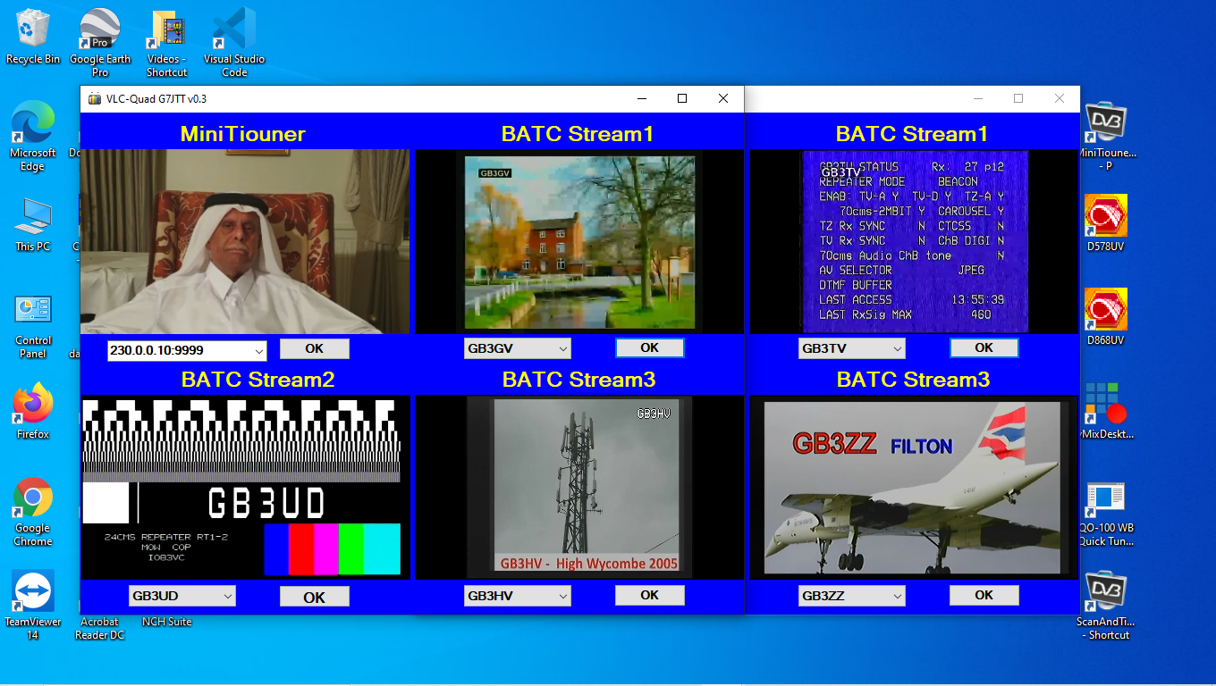

Thought I would try opening two Quads and overlapping
Screenshot (10).png (774.81 KiB) Viewed 18004 times
Thanks for your work John How about a six way one without The minitiouner ?
Roger G8HKN.
