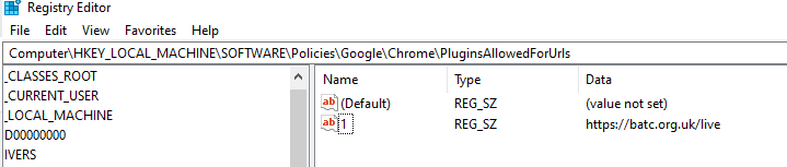

Many BATC Streamer users will, in the distant past, have edited the Registry on their Windows PCs to force Chrome to play the low latency Flash stream, rather than the slightly delayed HTML5 stream. That edit was described here: viewtopic.php?f=69&t=5626&p=17787#p17785.
Now that Flash has been disabled in Chrome, that edit needs to be reversed to allow the HTML5 stream to be displayed by default. This is the way that worked for me:
- Do a Windows search for regedit and click "Run as Administrator"
- In the left pane, click on "Computer" at the top of the list to start the search at the top.
- Click Edit, Find, and make sure that only "Keys" is ticked in the dialogue box.
- Enter PluginsAllowedForUrls (with the exact spelling and capitalisation) in the Find what: box and then click Find Next.
- When the search works, you should see the key in the image below.
- Right click on the https:batc.oirg.uk/live line in the name column and select delete.
- Close regedit and then close and restart Chrome.
- Undo Flash.PNG (9.6 KiB) Viewed 17494 times
