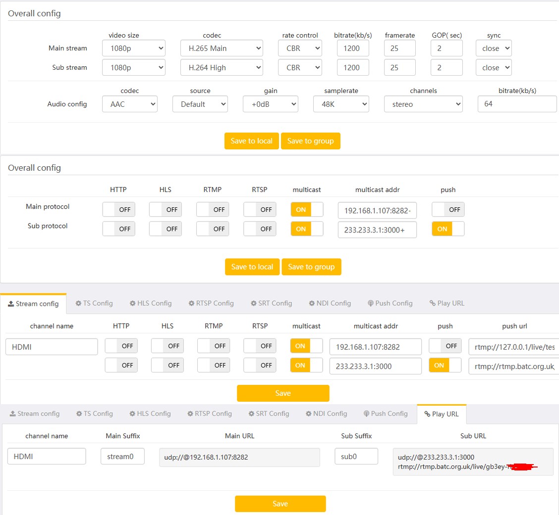

There's no need to use a Portsdown; the Link-Pi will stream directly to the BATC stream server.
Here is the config for GB3EY that uses this method:
Link-Pi config
Link-Pi config
Encoder config.jpg (147.11 KiB) Viewed 7480 times
You are interested in the Sub Stream settings; the Main Stream is sent to the repeater's transmitter.
Breaking the composite picture down, the top quarter is the Encode configuration.
Next one down is the overall Stream config.
Following that is the Stream config tab.
At the bottom is the Stream Play URL tab with GB3EY's key obfuscated.
Hope that helps
Clive G3GJA

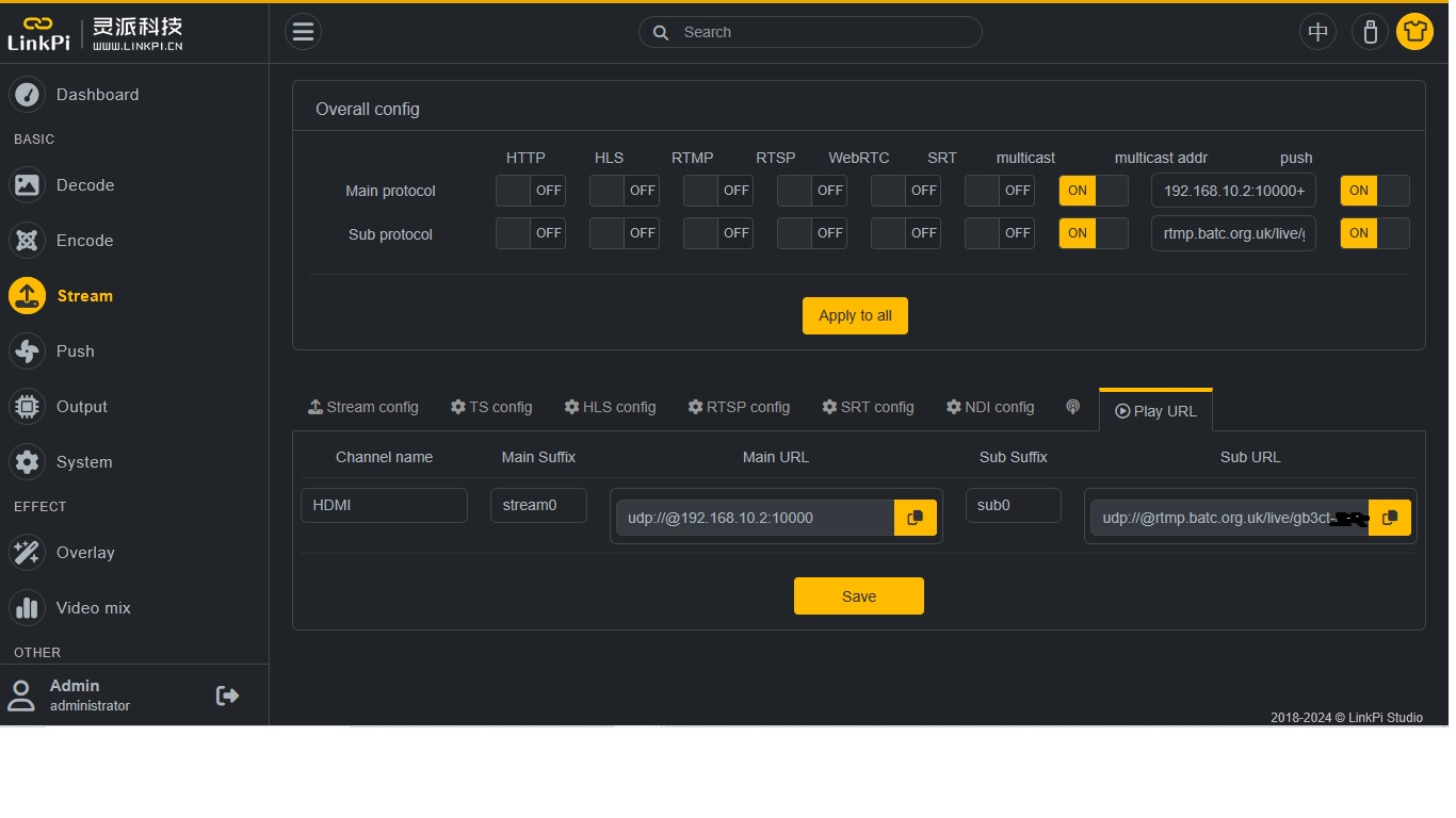

Thank you for the reply. It looks like my Link-Pi encoder has different firmware to yours as the GUI is different and it keeps putting a :0 at the end of the stream URL!
e.g. udp://@rtmp.batc.org.uk/live/gb3ct-STREAMKEY:0
I think this is why it isn't working

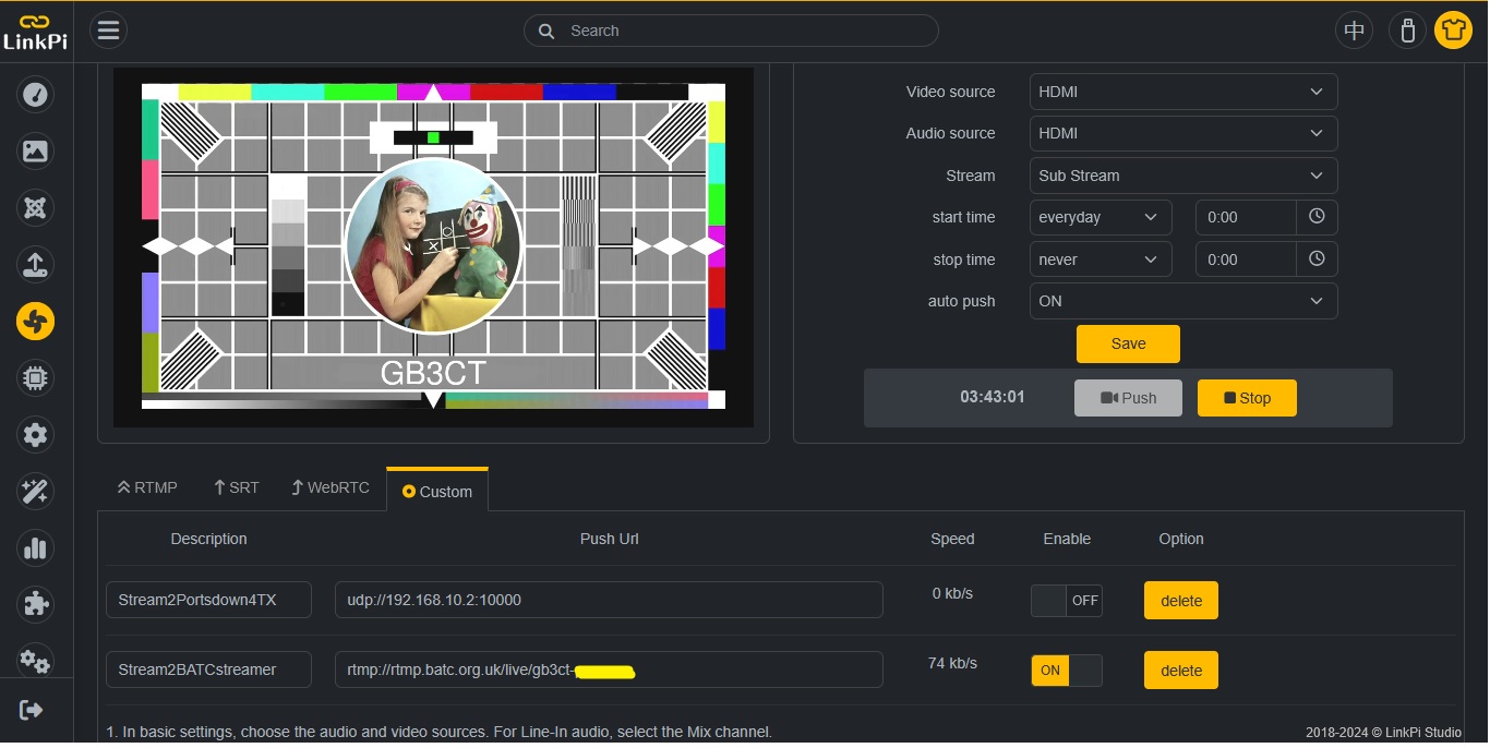

I figured it out eventually! The main stream configuration page would not accept the BATC URL in the correct format as it kept adding UDP:// to the start and :<port number> at the end of the URL automatically every time save was clicked.
In the push page as above, the URL could be correctly added in the custom tab (not the RTMP tab) with the sub stream selected for an H264 stream. At first the encoder was showing that it was streaming and CTs stream was showing as active, but not displaying video which was down to incorrect selection of main and sub stream, the main stream being H265.
Thank you both for your help :)
