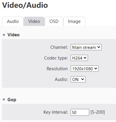

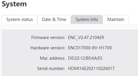

Hi Rob
Is your firmware version different to mine?
Mine also has an audio on/off control on the video tab:
I've set the sub-stream to 1280 x 720; does it needs to be manually forced and if so how did you do it?

Posts: 693
Re: Portsdown 4 Repeater TX and Stream
Post by M0DTS » Tue Apr 12, 2022 1:56 pm
My boxes have older firmware.... could be something to do with it. V1.60.190919
The reason i use the old firmware is that the analog audio input is actually stereo which we needed at KM, not mono on future firmware versions.
I think i have a copy somewhere of an older firmware (which allows stereo audio) but not that 1.6 version.
The streaming settings are controlled from a python script, i found i could manually force 1280x720 on stream2 without it breaking, instead of the lesser quality options.
My python bits n bobs: https://github.com/m0dts/HDMI-Encoder-Tools
