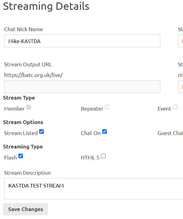

I've setup the account on the members page for streaming but my callsign is not showing up even in the members/offline list.
Is there something that I've missed, I've got list checked and such checked. Been about 3 days and still has not shown up.
One difference between the example page and mine is the callsign is not showing up in the greyed out box under output url.
Here's the link to the example and my page is in an attachment to this post.
https://wiki.batc.org.uk/Configuring_yo ... _Portsdown
- Capture.JPG (43.7 KiB) Viewed 17937 times

As seen in your attachment, the Stream Output URL in the Streaming Details section of your Account Dashboard was missing; once I entered your call-sign your stream became listed.
You should now be OK to make use of the facility; I checked and the streamer reports that you are 'K5TDA TEST STREAM'

Was it something I left off I tried to type in the box but it was grayed out
Re: Account not showing up on streamer
Nothing that you left out. Usually the sign-on process populates that field - on very rare occasions that does not happen hence I manually entered your call.
Sorry that you have inconvenienced, however now you can enjoy use of the streamer and you should not be troubled again.
