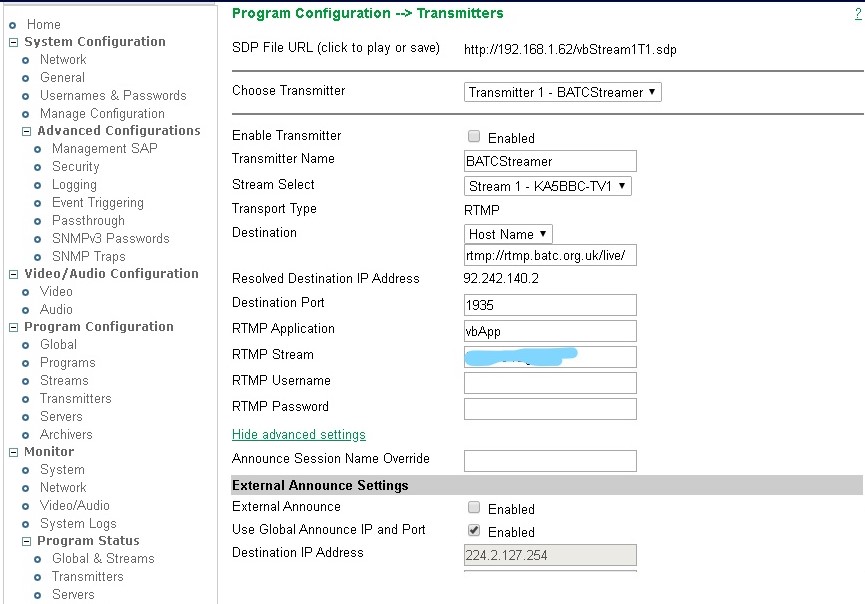

I am trying to configure a VBrick streaming device and the config page has more boxes to fill than the forum or wiki pages cover (see attached image).
What do I put in the gaps?

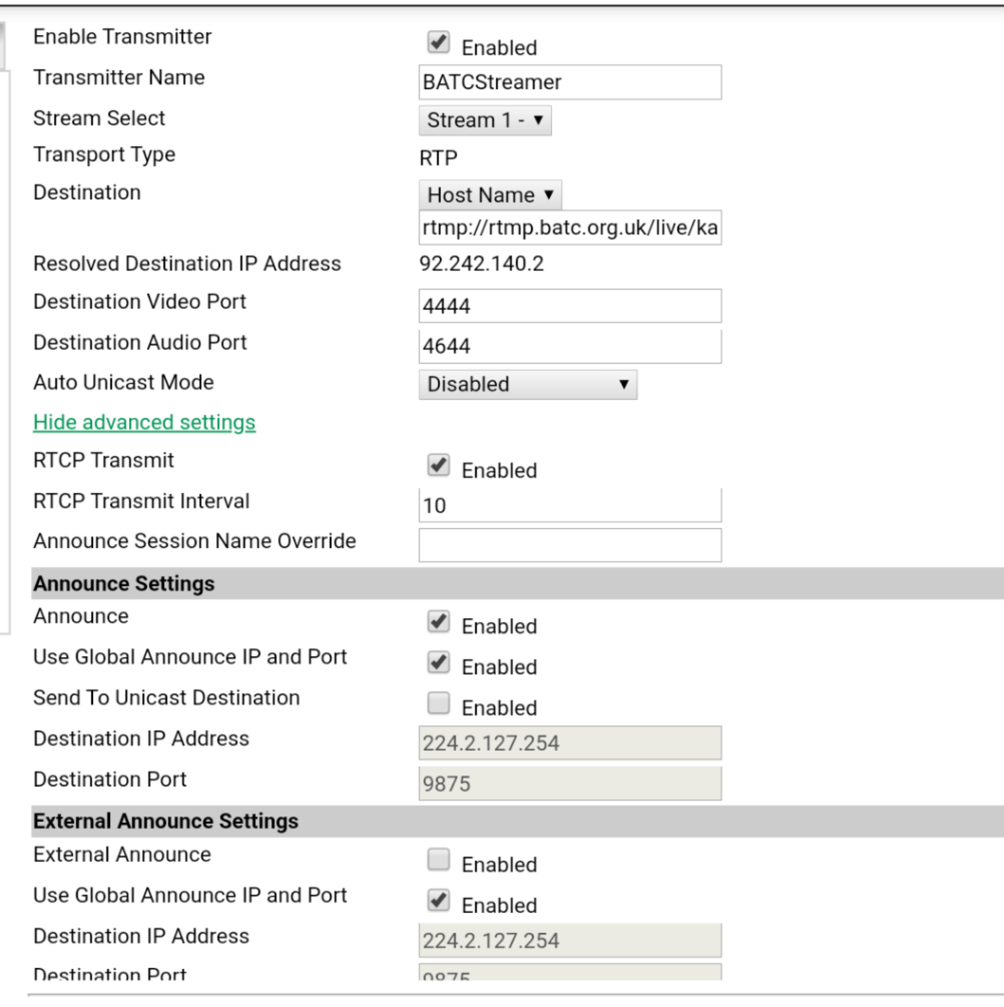

Strangely when I look at the same page from my phone 60 minutes after having saved what little of the configuration I have completed the view has changed...

Hi Andy
Transport type needs to be RTMP, and check that the destination address is of the form rtmp://rtmp.batc.org.uk/ka5bbc-keykey
The hyphen is impiortant.
