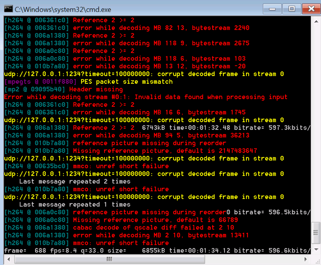

I have problems streaming to the streamer...
I can reach the streamer and actually I can see my stream but I get a lot of errors...
I loaded the last ffmpeg version: ffmpeg-4.1.3-win32-static as suggested (even if I have a 64K system).
I am using MiniTioune_V0_9beta8_9 and a MiniTiouner Express board.
I attach here a copy of the "flow" with highlighted in red the errors I get.
thanks in advance for any help you can give me!

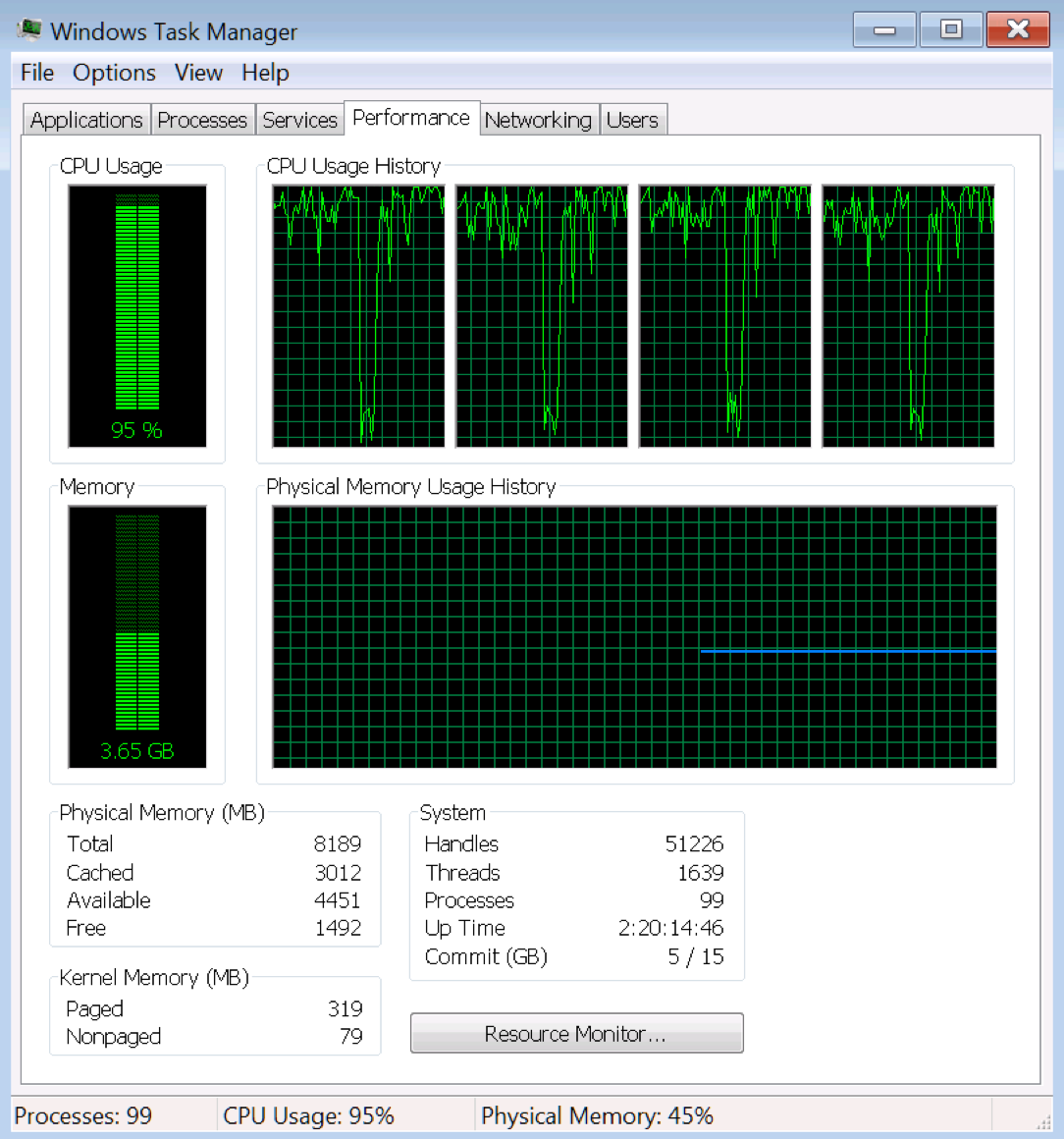

Dave, I think you are right! Why did I not think of this?
Hitting 70% just on ffmpeg and 100% on processor (it's Dell XPS 630i a Core 2 QUAD with 8GB RAM and C drive is a 512G SSD its a few years old now). Memory usage is under 4GB
It's a 64 Bit version of W7, is it possible to use the 64Bit version of ffmpeg? Unless you know of any optimisations that would help?
