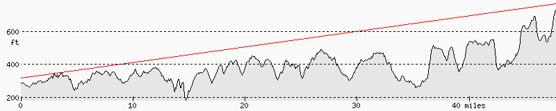

Thanks Arthur
Looks ok on flat earth not so good on curved earth :D

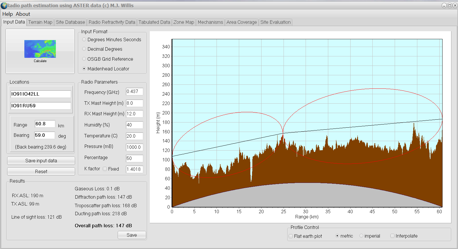

Line of sight almost for me

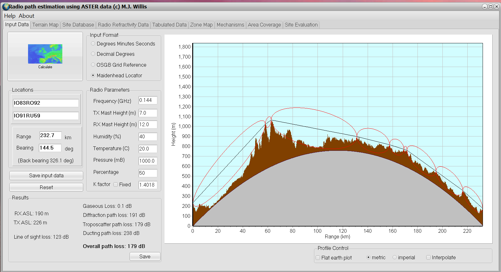

From Bolton, not so good, but you never know.

Have to get laptop out Mike and try it on your program ……not always convinced hey what’s that is that accurate
