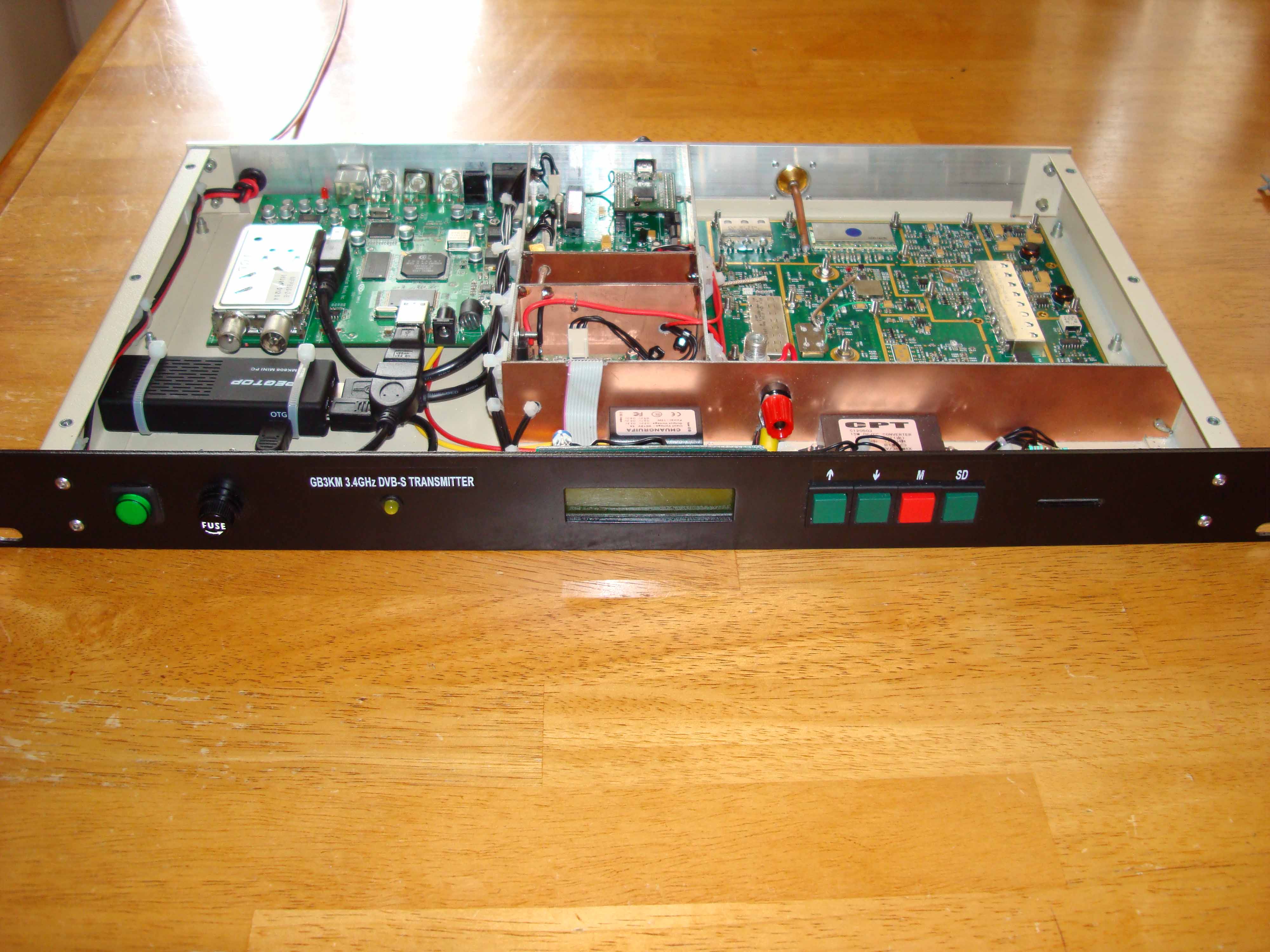

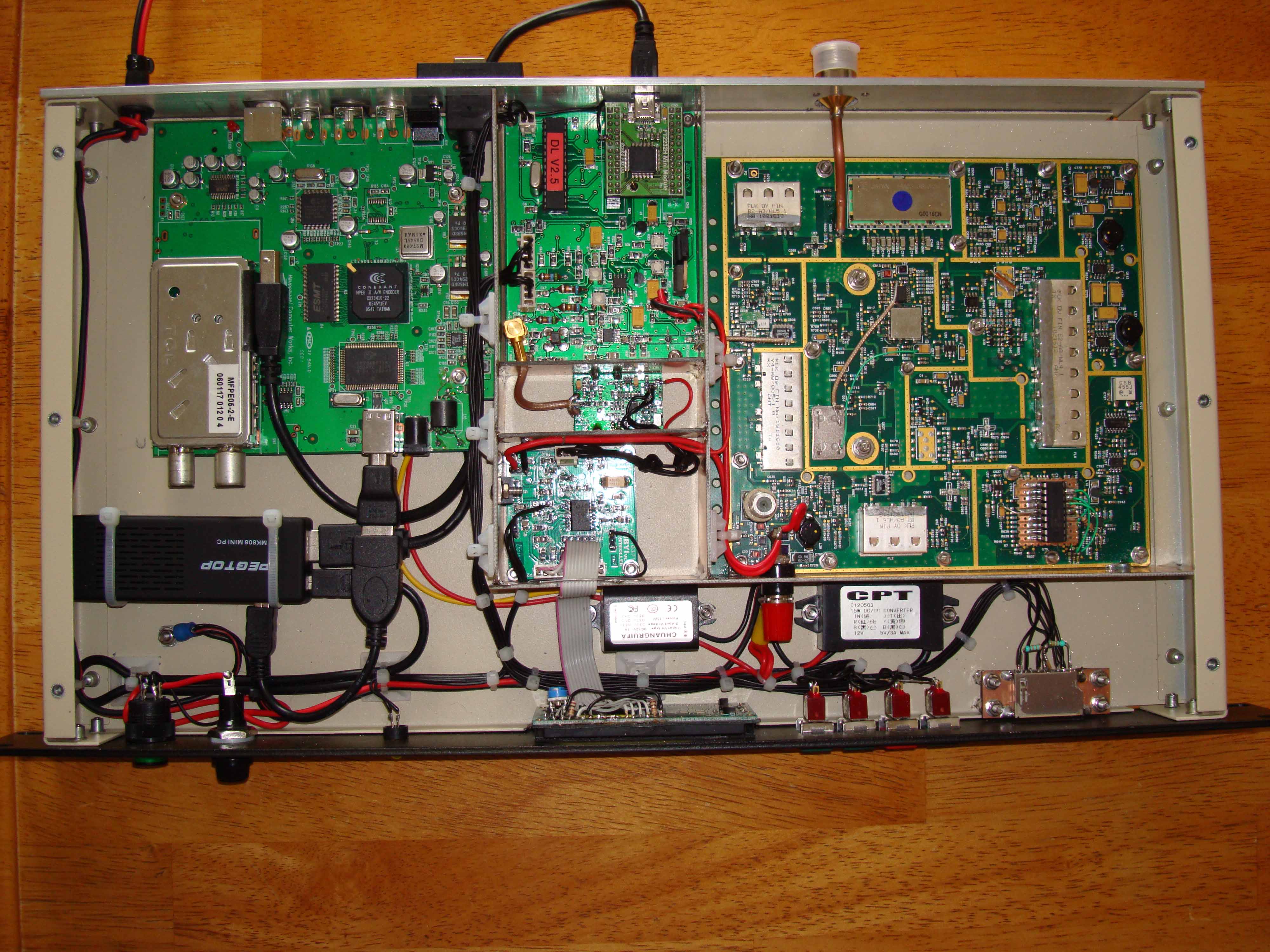

GB3KM 3.4GHz stand alone digilite TX
Front panel view
Front panel view

Post by EddieG0EHV » Fri Jun 07, 2013 4:54 pm
Looks nice!
Catch you on the contest tomorrow.
