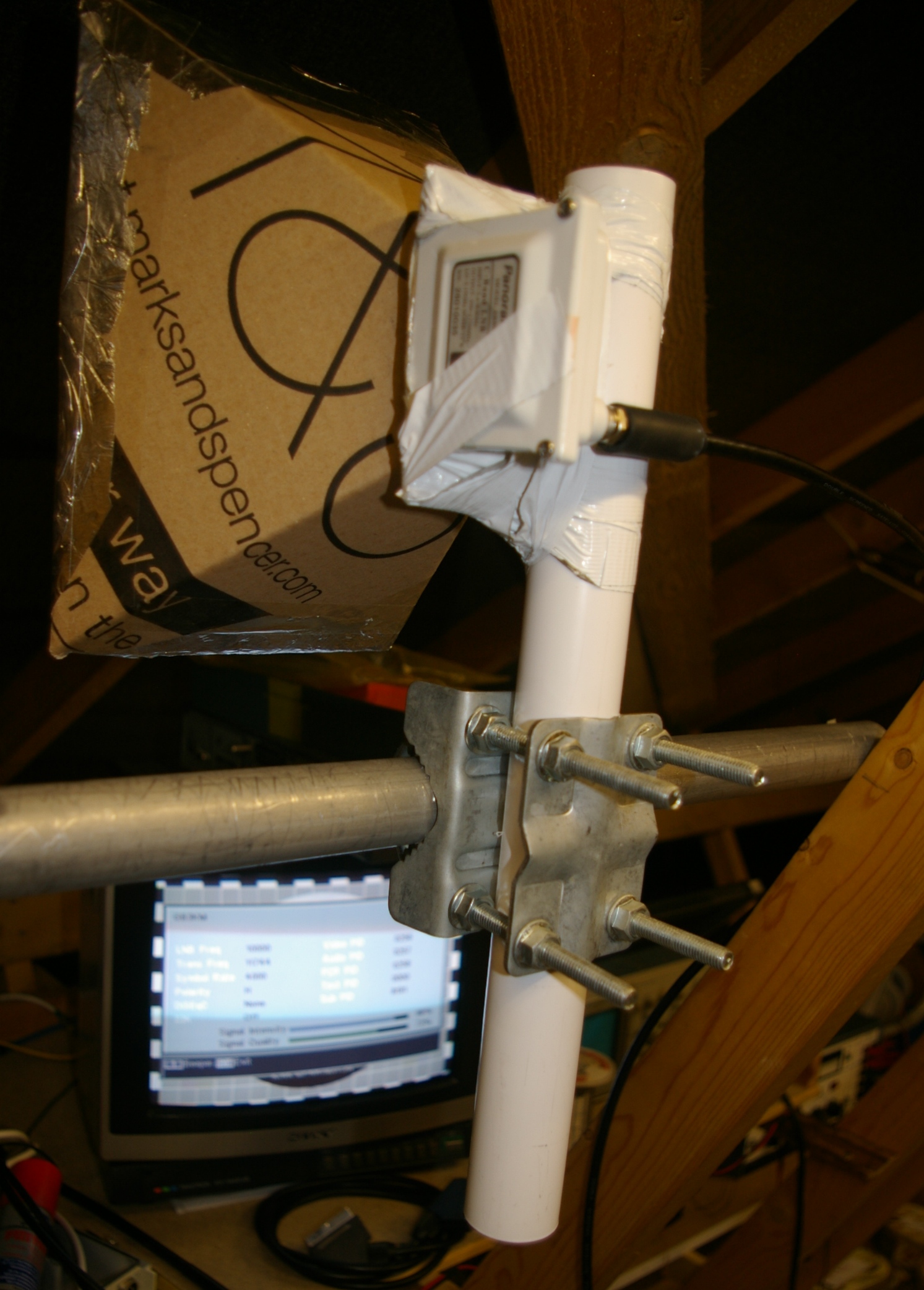

Happy to report super pictures from GB3KM with a "quick and dirty" horn antenna.
Located indoors in my loft, gain about 15dB and using the Panorama ER-863 lnb from BATC at Finingley.
Only a sniff of a signal with bare lnb but the horn makes a considerable difference.
Microwaves do work in lofts
Regards,
Eddie
G0EHV

Re: 3.4GHz DATV Output
Eddie,
Great idea, but you should have used a Waitrose box - it would have been worth at least another 2 dB

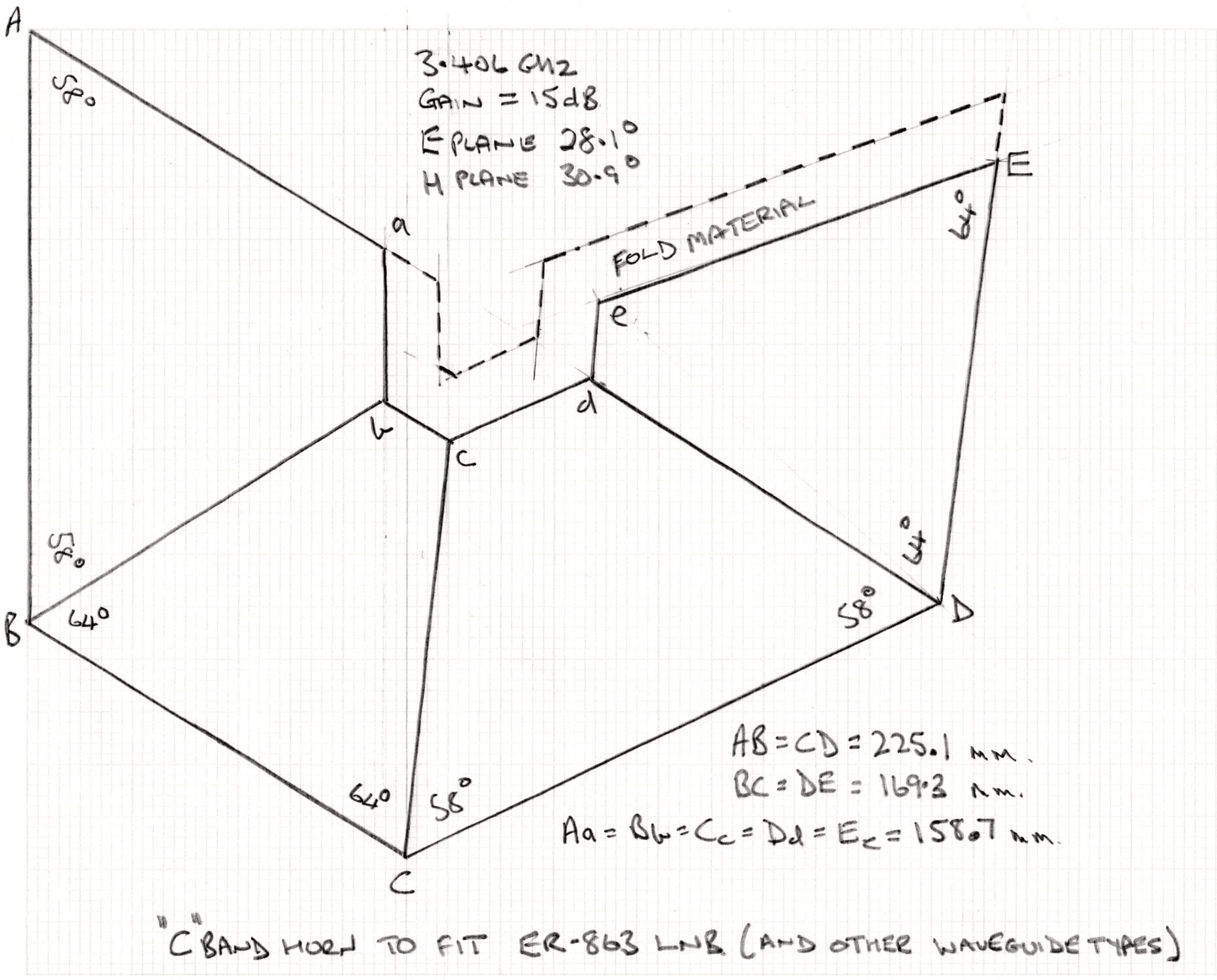

I've had a few requests on the KM stream for horn info.
See attached file. Drawn half size on graph paper (Thats an analogue medium!)
My horn was made from M&S Taste the Difference cardboard and covered with aluminium foil before folding.
Other cardboard may work just as well
Tinplate or solid brass, copper or what have you would be better outside
Don't forget the extra material shown to enable a simple flange and seam joint.
I stuck my flange to the lnb with double sided stick pads.
Regards,
Eddie
G0EHV
