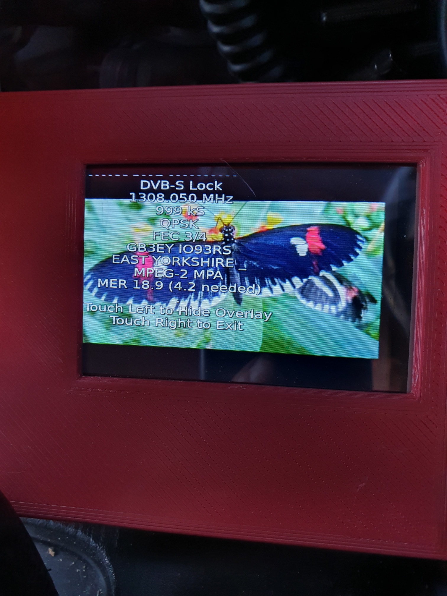

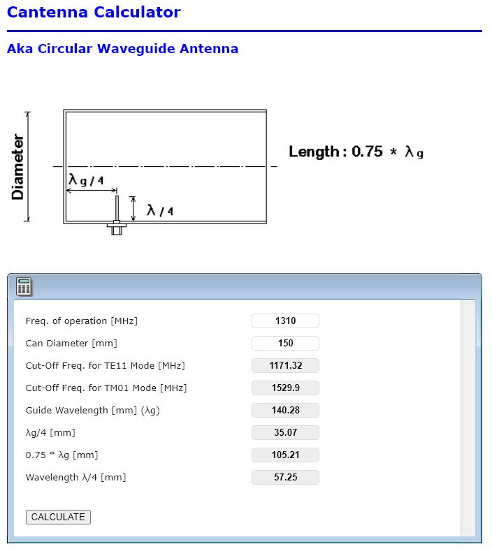

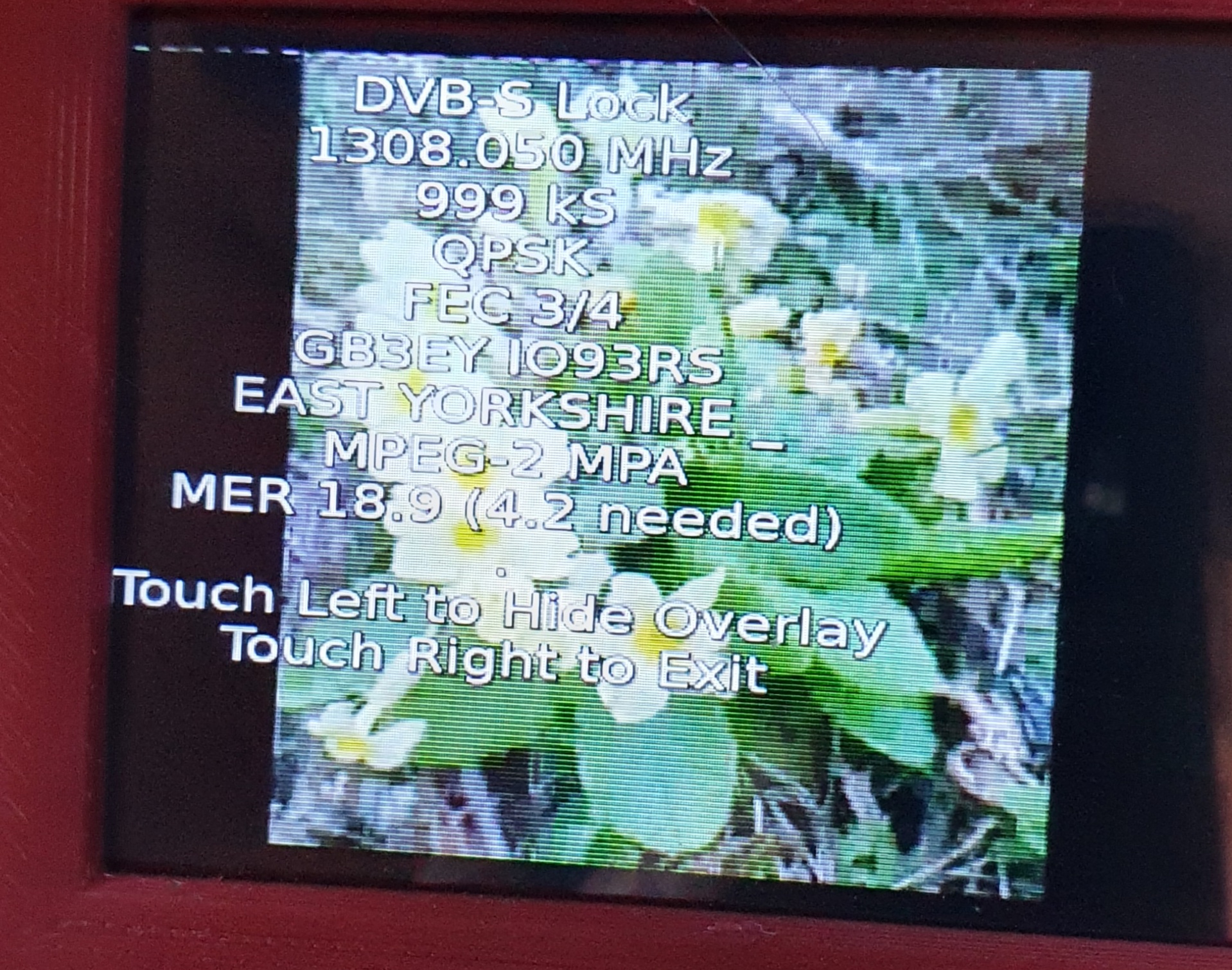

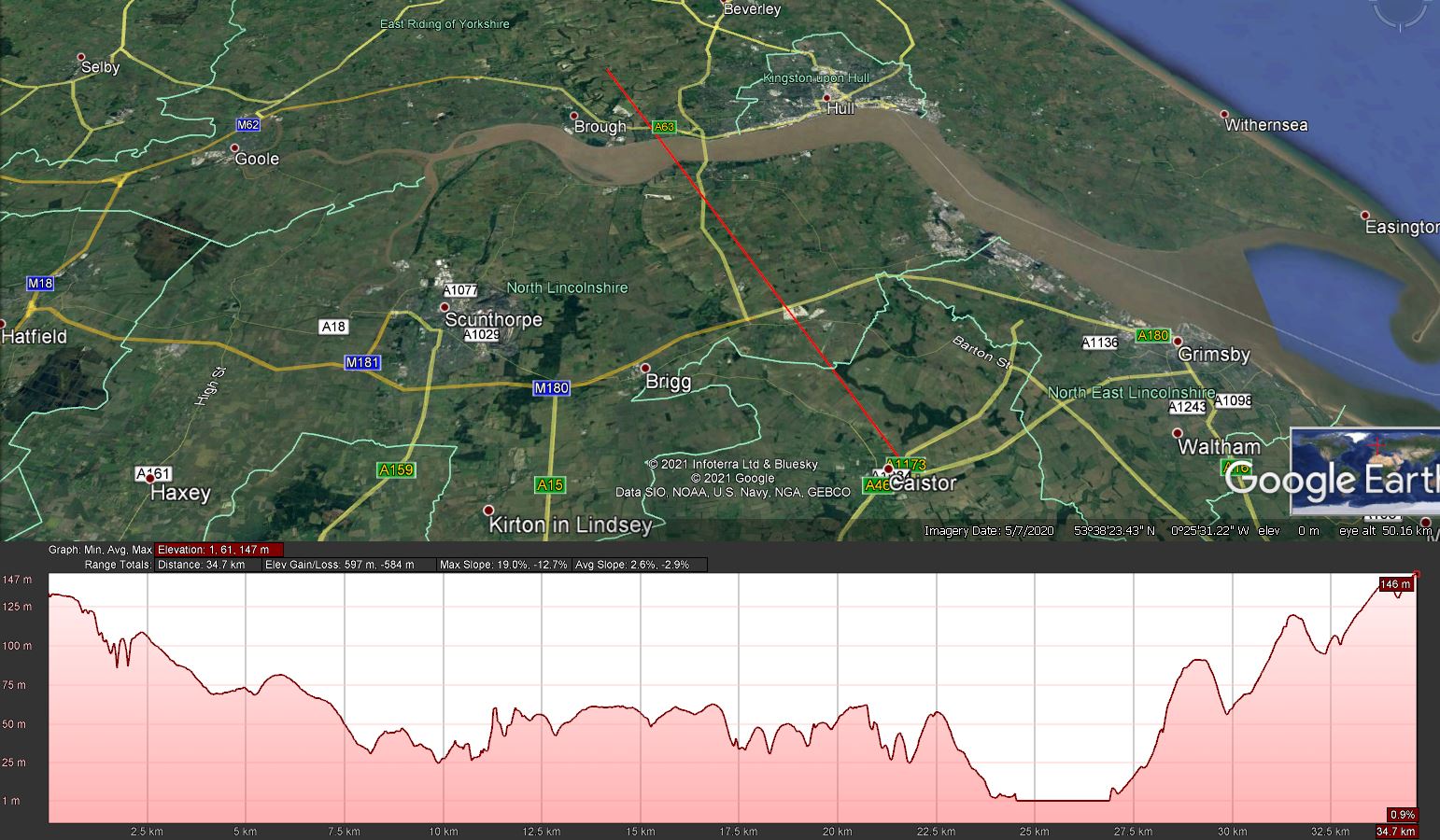

I went up to caistor in Lincolnshire tonight to test simple antenna the Cantenna. well happy with the results
just coffee can no preamp and minitioune on a pi3 running portsdown 2020
