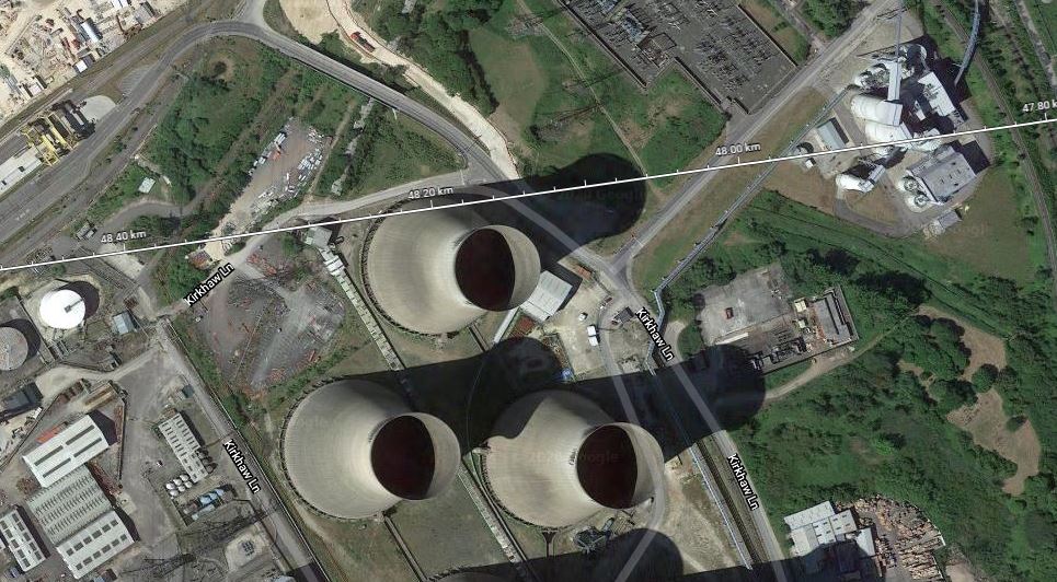

New location, the site owners might not like Antennas but this should be the new signal path, because I will be higher up I think it will pass OK..
But YT (which none of my Telly mates can see) will be right in my line of sight.. :lol: You couldn't write this stuff..
