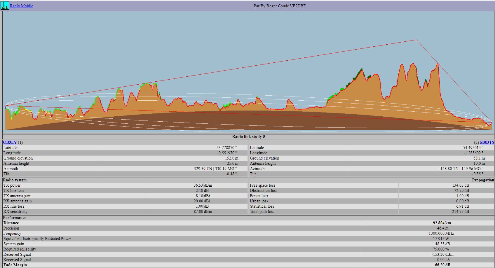

Rob, it would be quite something if you managed to see it from home! The path doesn't look good and will need aircraft scatter or tropo refraction to get it over the lumps. I look forward to seeing your reports. 73 Clive

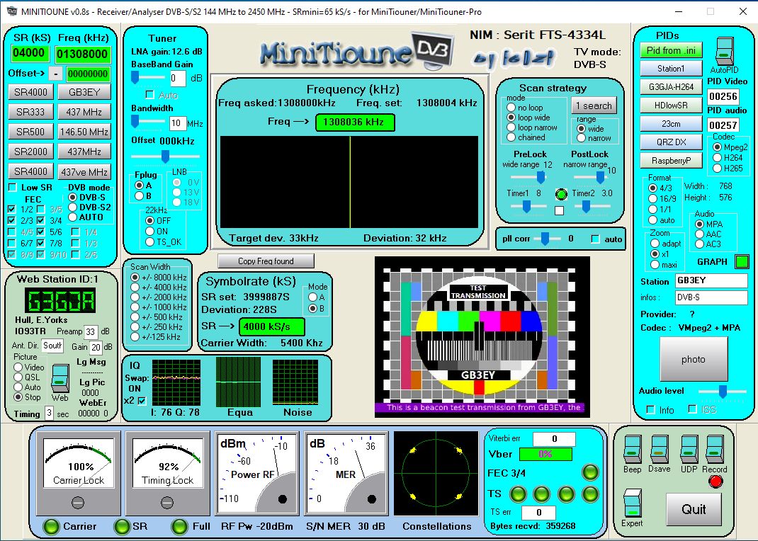

GB3EY as received in IO93TR09, 9.9km from the repeater
- GB3EY @ 25m.jpg (231.27 KiB) Viewed 18463 times

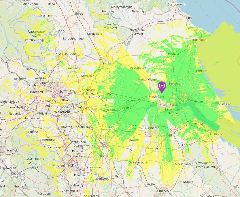

Thanks for trying Gary
I suspect that a mast-head pre-amp is essential for your area. Coverage map as below assumes a pre-amp and a 10m mast: 73
Clive
