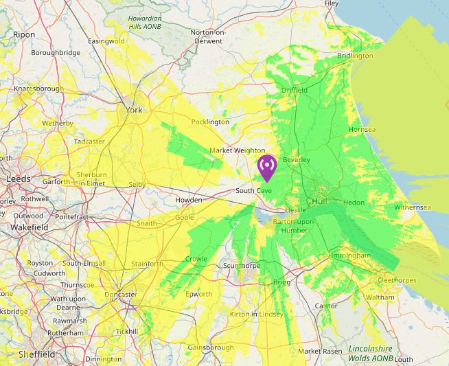

Following two full weekends of engineering at the Cave Wold repeater site, GB3EY is back on air with the antenna now at 14m AGL. This is the height of the Alford Slot when the Versatower is lowered. It will stay at this height for a whilst we complete work on the new feeders for the other antennas on the tower (2 x 2m folded dipoles for GB3HS, 70cm colinear for GB7HU, 2m/70cm colinear for RAYNET use and 2m/70cm dual band yagi for DATV receive).
The height is now sufficient to clear some of the high ground to the west so I look forward to hearing reports from Eggborough and Barnsley!

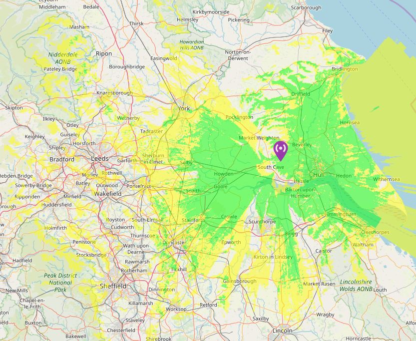

The antenna height will be at least 25m when the tower is fully extended but for now the beacon coverage should be as below. Note that the coverage map assumes a height of 10m for the receive antenna with an isptropic gain of 18dB and a masthead preamp.

There's still nothing to be seen at Eggyborough I'm afraid Clive :cry: not even a mark on the frequency waterfall at 1308MHz.
I'll take the gear out in the car to see if I can receive anything from any of the local high spots, unfortunately the highest (man made) spot is gated and inaccessible to us mere mortals

But to be fair... My antenna can in no way be 10m AGL high, although the surrounding trees may be.. and for the time being there is no mast head amplifier, I rely on one in the shack..

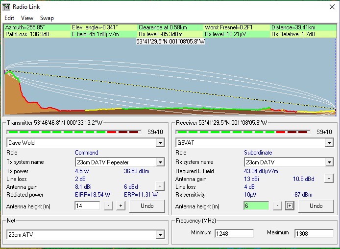

All noted Graham.
To make it a bit more realistic, I've reduced your antenna height to 6m and added 4dB feeder loss to replicate the lack of a masthead preamp. I've used an antenna gain of 10.8dBd / 13dBi which hopefully you can at least match, or better, exceed.
Even with 4dB feeder loss you should be getting 12.2µV at the bottom end which might just be enough for some receivers. Probably much better with a LNA between the feeder and the Rx. That feeder loss is the equivalent of 14m of Westflex with N plugs fitted.
It was interesting to see with the repeater's antenna at 14m, that changing your antenna height, starting at 1m above the ground, makes very little difference to the signal received. Putting the repeater to its predicted height of 25m makes your end much more sensitive to height such that the signal then triples from 1m to 6m AGL.
All the above assumes you have a clear path to the repeater but from what you have said it sounds as though you have trees in the path to EY. That is an issue as we have just found out. G4YTV is on a path from EY that follows the line of a copse and as soon as the leaves got wet the EY signal dropped significantly.

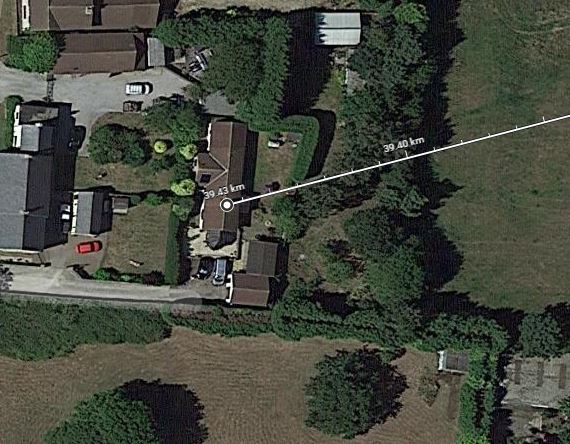

Cheers Clive, I was gonna say earlier please don't quote me Dbm or uV or whatever, I've never felt able to justify spending money on things to measure these sort of things.. :D One day, I say... One day...
But anyhow, I stopped on the Motorway bridge (the highest open point for miles around) on Monday with the receivers in the car and a Yagi and was amazed to see, bugger all. But there was a lot of it..
Tuesday was a complete washout, I didn't even attempt.
However, Tonight on the way home I had another look around at the Bridge and without any effort, there was EY... Yay! I'm presuming that some work has been done in the meantime?
So I just got back from a tootle around the local area with just the Alford slot, Bob Platts preamp and both a Comag and Satlink..
Here at IO93KQ, EY is a well locked signal on any East facing open ground, the lock disappears readily on the slightest movement. but behind any crops, trees or bushes, there is no hope...
At home I got my best Yagi out and using the Satlink and Bob Platts, had a good look around at ground level, trying to aim through any slight gaps in foliage, but there was nothing. At the weekend I'll head up to the roof with the best Yagi and Satlink for a better look.
There is no signal still seen on the chimney antenna at home.. I'll need a pole of around 10m got get an antenna above the trees (see Below).. but then EY is inevitable.
Home to EY.JPG (75.71 KiB) Viewed 19978 times
