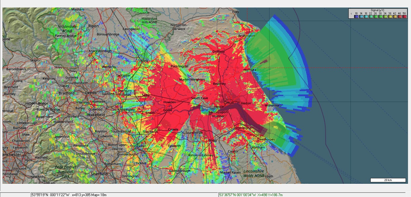

A new NoV was issued for GB3EY in August allowing us to move it to the East Yorkshire Repeater Group's site at Cave Wold Radio Station near South Cave in East Yorkshire. The new site is 155m ASL with a good take off in most directions. The predicted coverage was created using Radiomobile and assumes 10m mast with a 15dBi antenna at the receiving end. This will be a substantial improvement over the old site on the North Sea coast at Aldbrough.

Thanks for the Info above. Im hoping I can see it and get in from Home in Barnsley. Its going to be marginal so fingers crossed.
