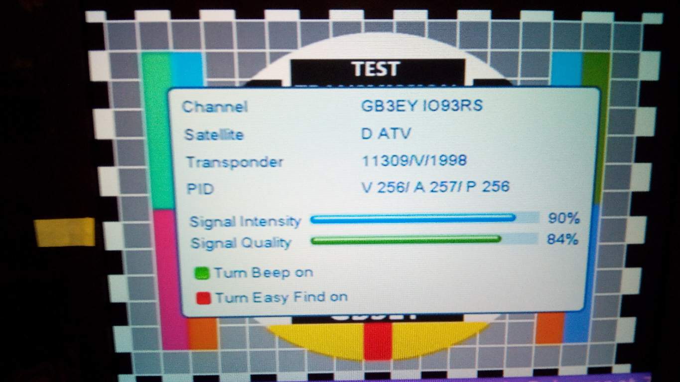

Post by keng8vdp » Sun Dec 01, 2019 6:42 am
Very nice
Ken G8VDP
G3GJA
Posts: 415
Re: GB3EY Repaired
Post by G3GJA » Wed Dec 04, 2019 10:03 pm
That's looking pretty good Ken.
Any further thoughts on why it disappeared?
Clive

Post by keng8vdp » Wed Jan 15, 2020 11:47 am
Clive
Of course, I blamed Brexit & the election. Now theres no real telling if I was right as one month on and into 2020. All is well.
I did find out that with preamp OUT, I get nothing and/or with Filter OUT I get nothing. So, I need both in.
Aerial then preamp then filter = GOOD. Aerial, Filter then preamp = Not as good.
The preamp is in the shack but im only 10ft under the aerial (38 element) so no long cable run.
The preamp is one of the old DB6NT ( Kuhn) type with the silver wire loop in it. I have found in the past that this loop is very suseptible to temperature which effects its tuning. just taking the lid off effects it. I find if i put my finger anywhere near that loop the thing can get better or worse.
I'ts so tempramental it could even depend on what week in the month it is (if you know what I mean) ! It could have just been that.
In the better weather im hoping to get a new RF switched preamp I have , up at the aerial. Hoping you have the RX in soon ( smiley ) because I might also have a second beam up at the same time.
