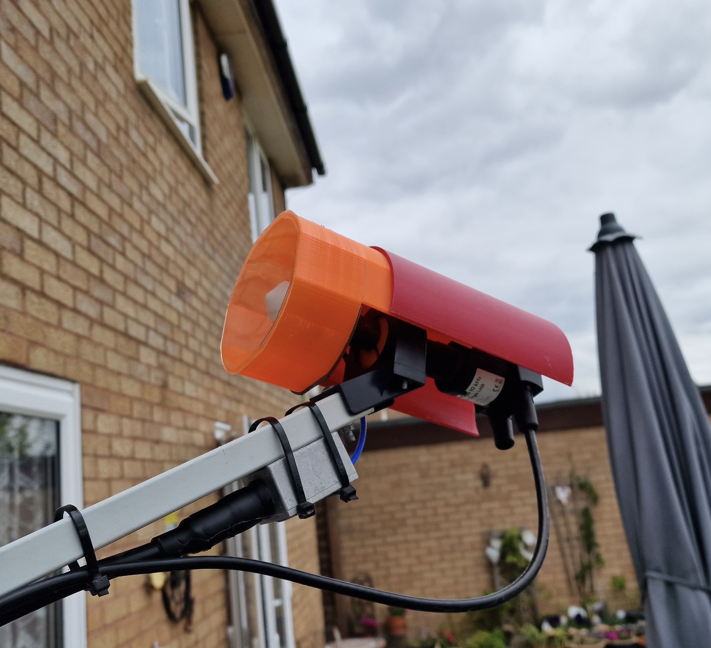

A picture is worth a 1000 words....here is my solution. Untouched for 3 years....you can see where I had to cut away some of the support arm to get it to sit right. Beacon MER 9dB on an empty satellite, its a 1.05x1.0 dish mounted upside down to reduce windage. The pointy lens is one I made from rexolite to a published design. Took HOURS on my lathe!!

Re: POTY Lens for shallow dish
Never had a problem with water in over 2 years.
