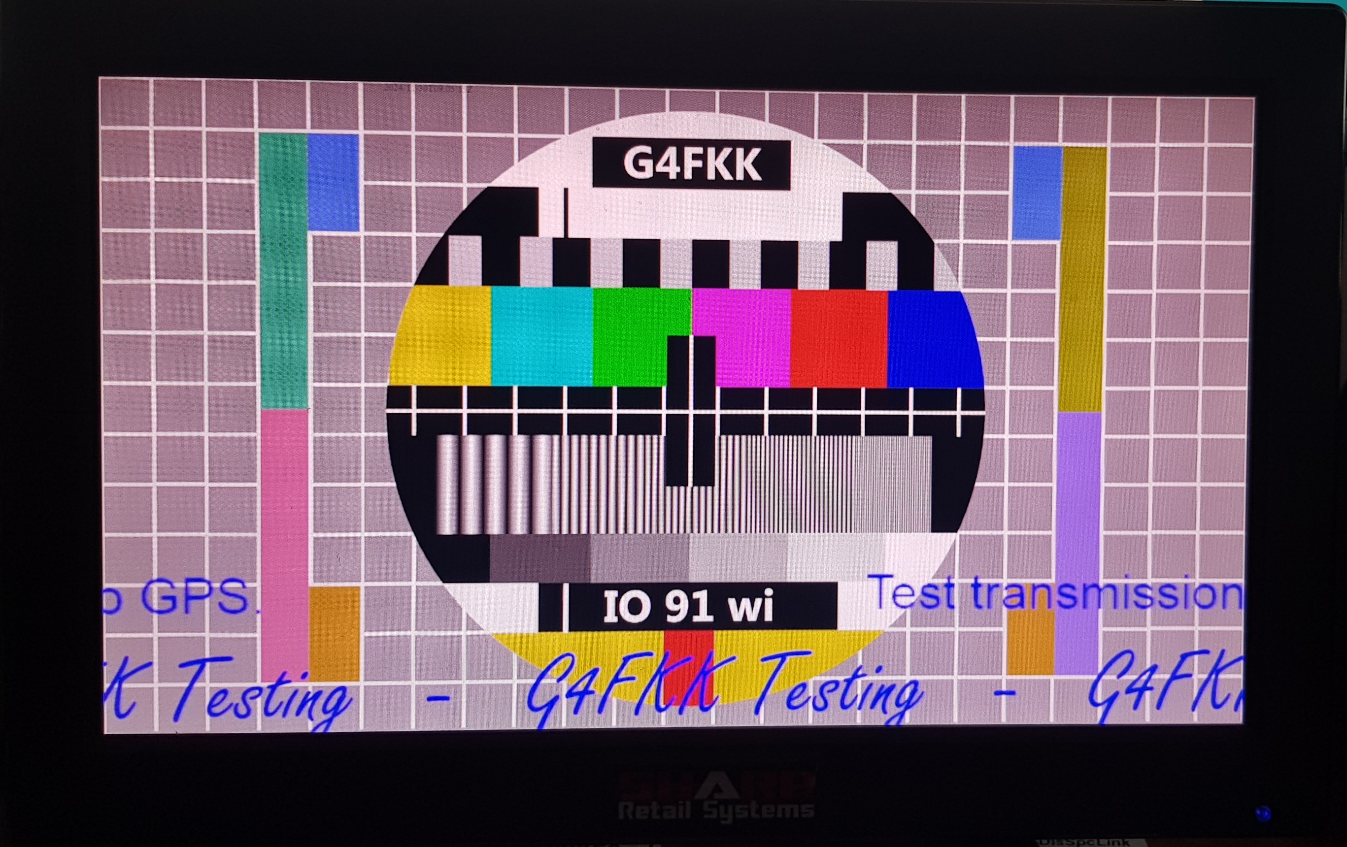

What do you need to get started.
You can use OBS to send and receive SRT.
I use OBS to send and SRT Player fo recieve which is installed on RPi Pi 3B.
https://streamrus.com/player.html
You can download FREE image and install on RPi 2,3,or 4.
Today Martin G4FKK and myself have been testing with excellent results two way.
Hope to see you soon on SRT
Martin
G8KOE
Take a look at video on YouTube
The real difference between SRT and RTMP
https://youtu.be/mT8uJIbb2e8
Martin
G8KOE
- 20241130_090517.jpg (1.08 MiB) Viewed 13702 times

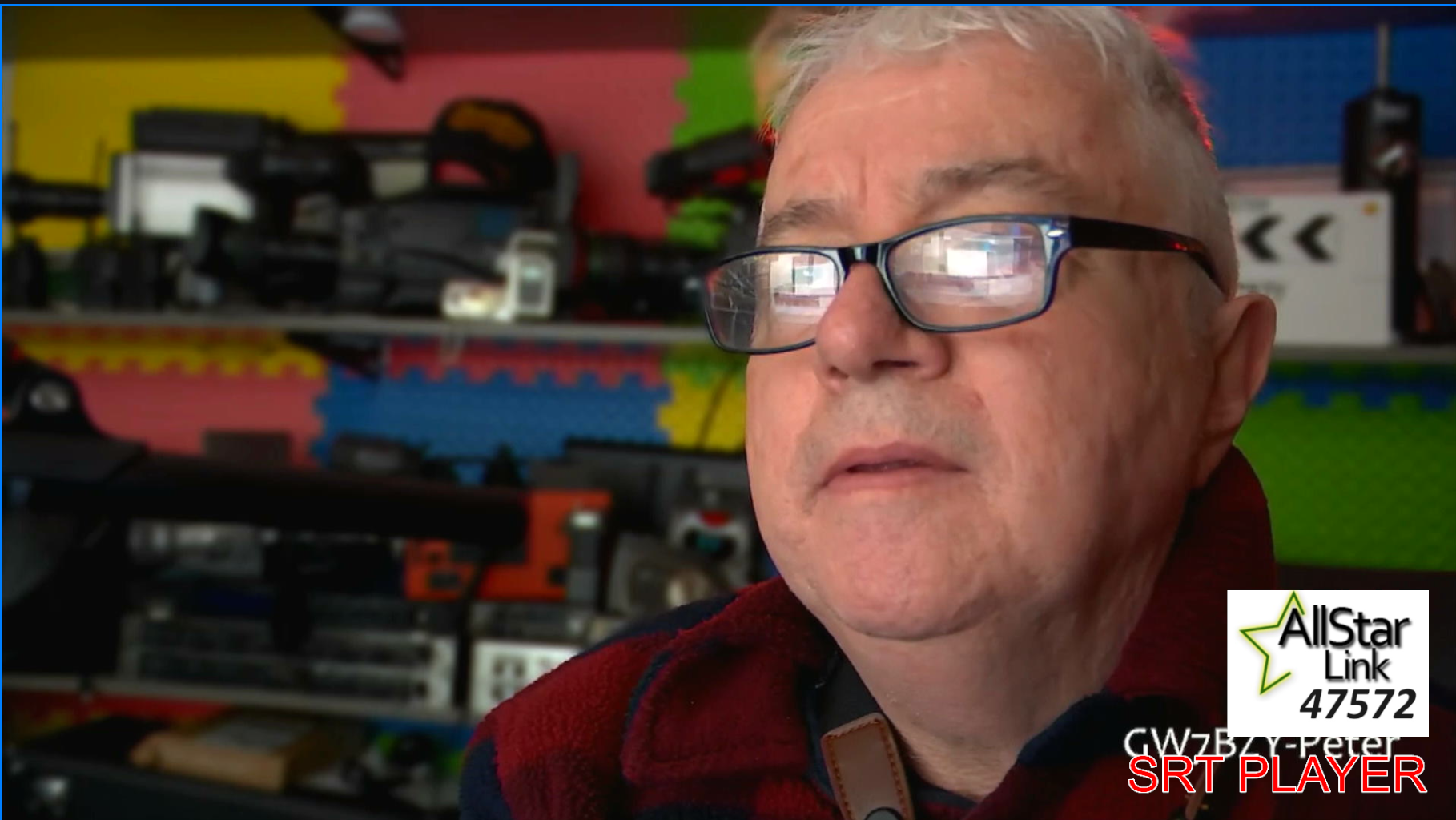

Re: Secure Reliable Transport
Hi Thomas,
Thank you for more useful information.
Another successful tests with Peter GW7BZY
Only problem we had was that he uses vMix and it did not like my ddns.net address.
Martin
G8KOE
Martin
G8KOE
- Screenshot 2024-12-02 152720.png (1.63 MiB) Viewed 13233 times
