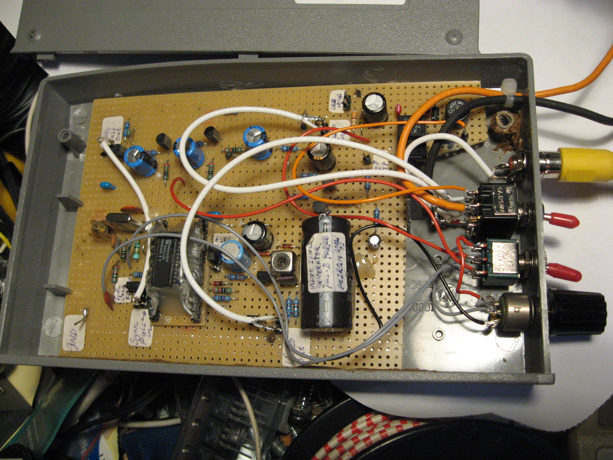

Otherwise build the circuit on experimenters board?
blue screen killer.JPG (1.23 MiB) Viewed 43473 times
I was thinking about making the pulse with a NE564 to ‘open’ the screen and as soon some sync is detected to have it locked to the incoming circuit..
Or maybe something with an Arduino and a LM1881?
Good luck,
Chris PA3CRX
