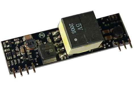

That would be great and maybe there is even room for an (optional) Power over Ethernet module.

Good idea, PoE would make a lot of sense too
Re: Minitiouner
Agreed, Power over Ethernet would make for a simpler and tidier installation.

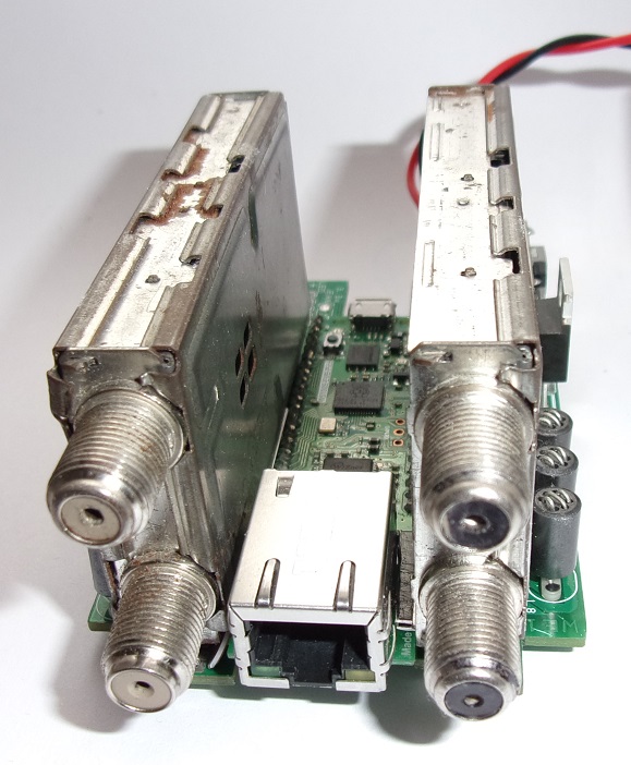

The PicoHub approach using a WIZnet W5100S-EVB-PICO module, described in CQ-TV 276, can provide a USB or Ethernet connected 2 or 4 channel receiver.
The Portsdown / Ryde / OpenTuner software would need to be changed to treat it like a WinterHill, over USB or Ethernet. An I2C pass through mode could be provided, for direct control of the NIMs.
There's probably no reason why a 'do everything' pcb could not be designed, to give FT2232H, Pico USB and POE Ethernet connectivity.
Emulating an FT2232H with a Pico for MiniTioune connectivity would be an interesting project. I don't know enough about USB to know if that would be possible.
