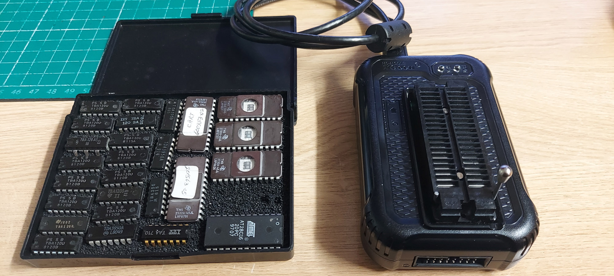

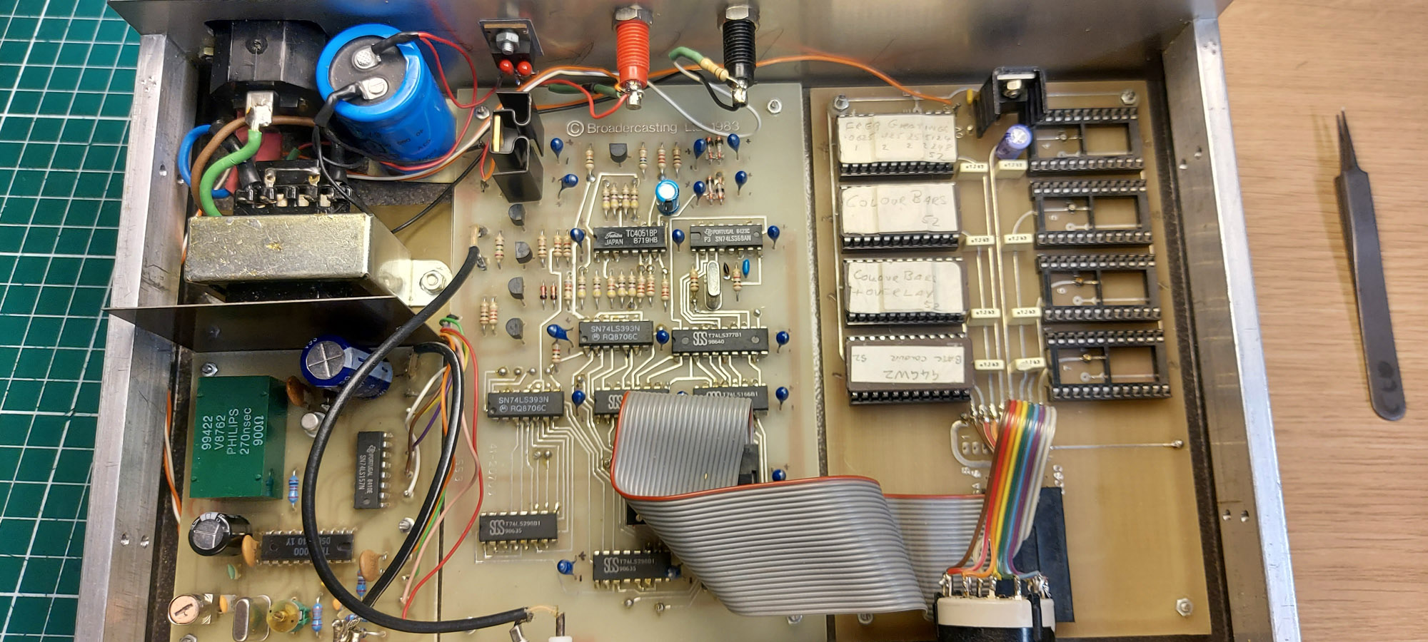

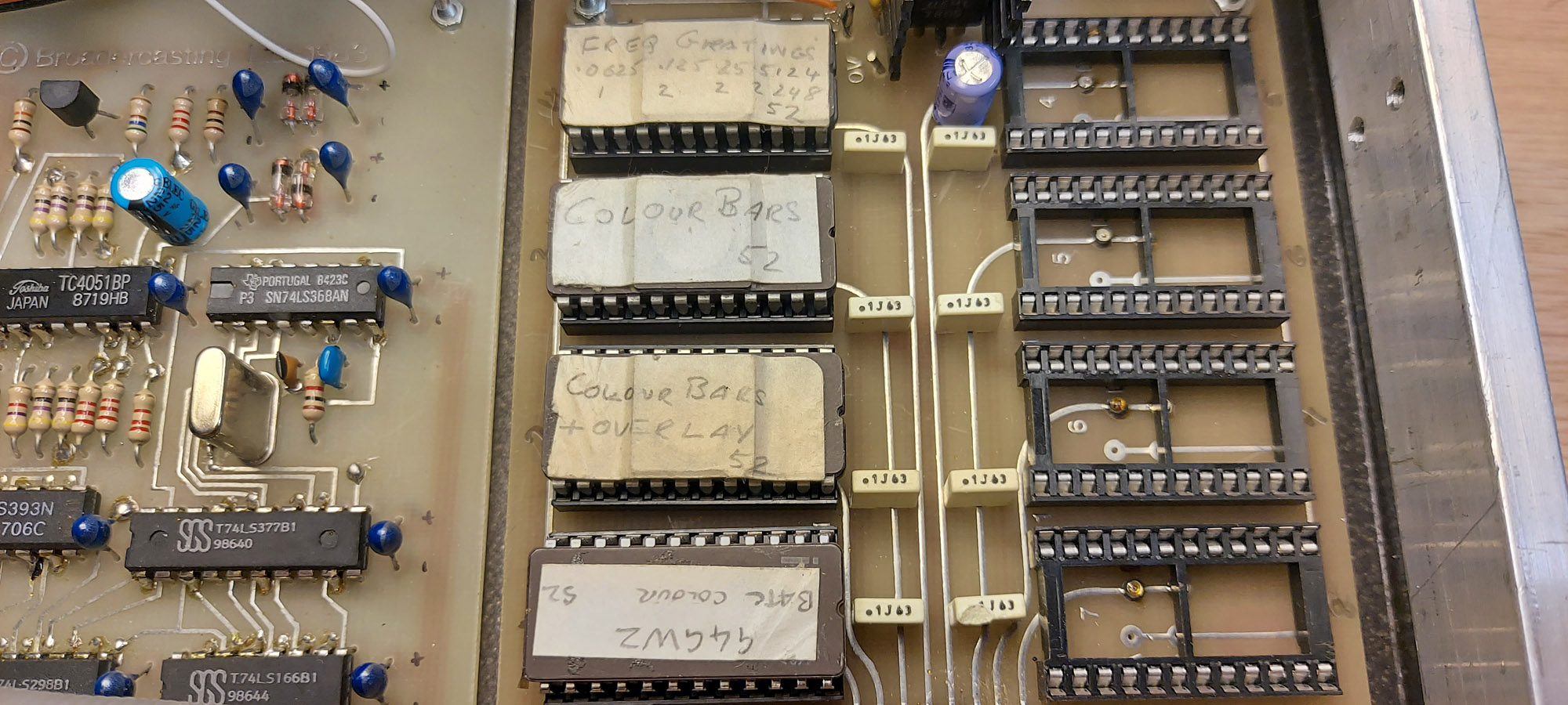

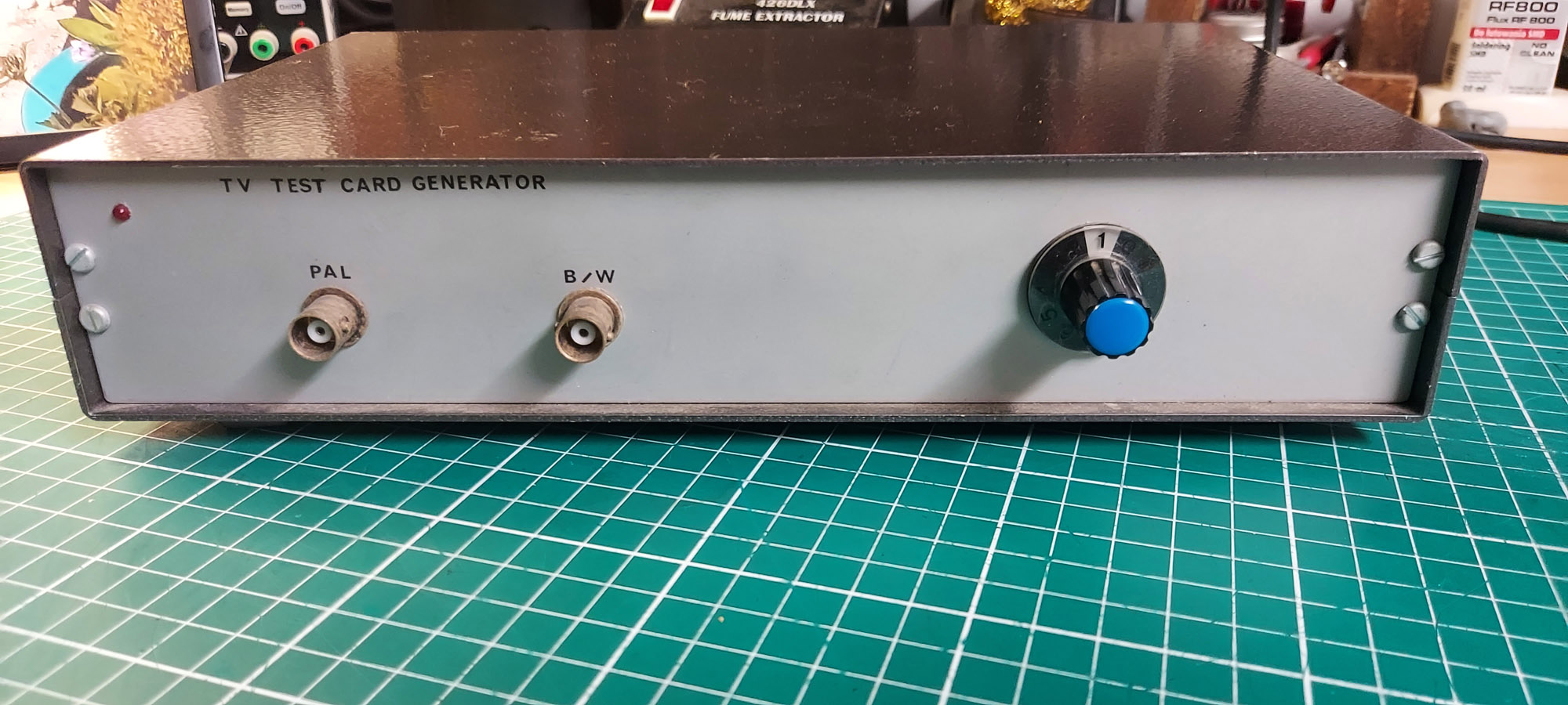

My main interest is vintage television restoration, and one of my tools I have is an old B.A.T.C test pattern generator. The device has the ability to select eight test patterns that are stored on EPROMs and accessed via an 8-way selector on the front. Although the device has 8 options, only four EPROMs positions populated, leaving four spare slots.
The EPROMS installed are TMS-2732A, I have a T56 programmer and have managed to read the four installed EPROMS saving them to .BIN files. I also have 4 new 2732A in stock, what I'd like to do is populate these new EPROMS with new test cards and add them to the generator, thus extending it's capability to eight test patterns.

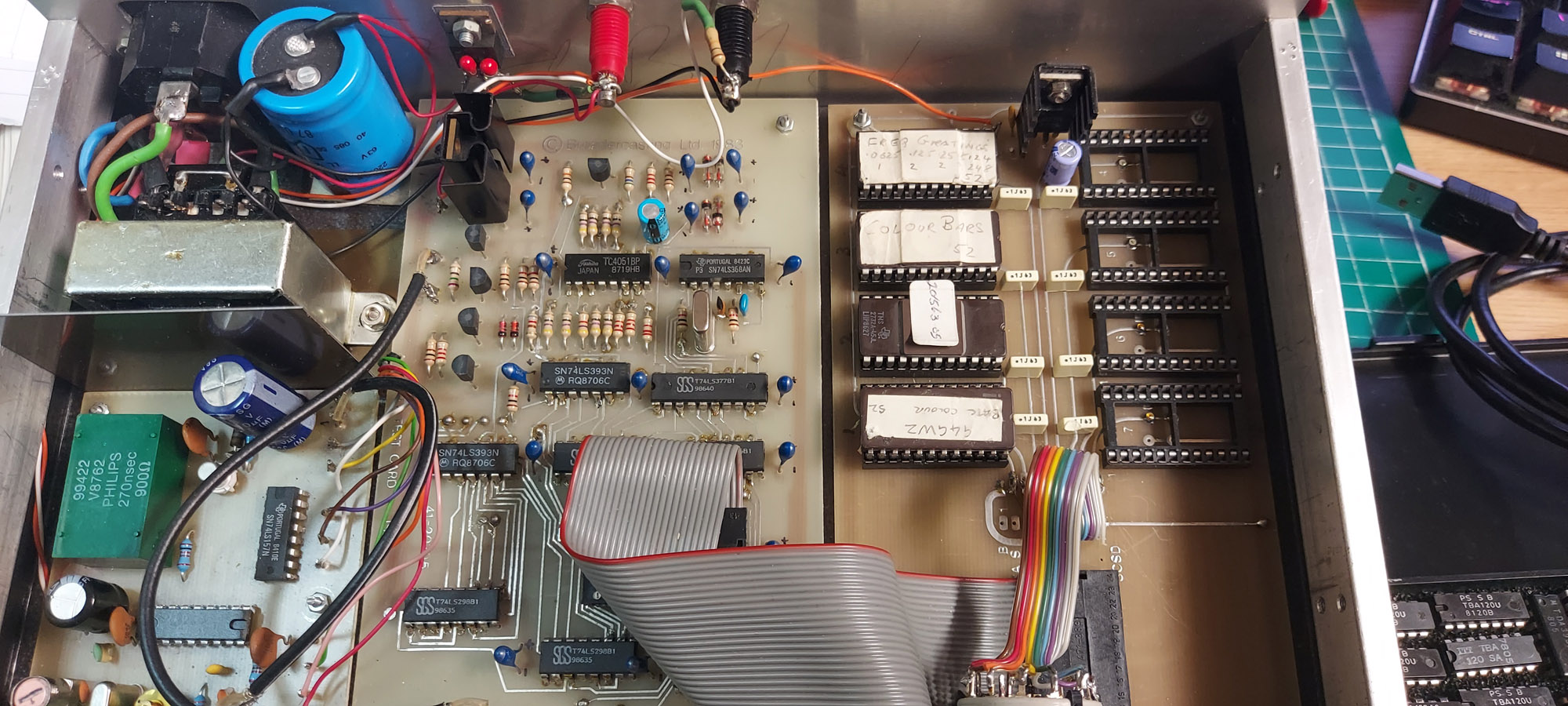

Indeed these boards seem to go on and on, looks like you have the 8-way board we did and also the Video AGC board far left with the green block on it!

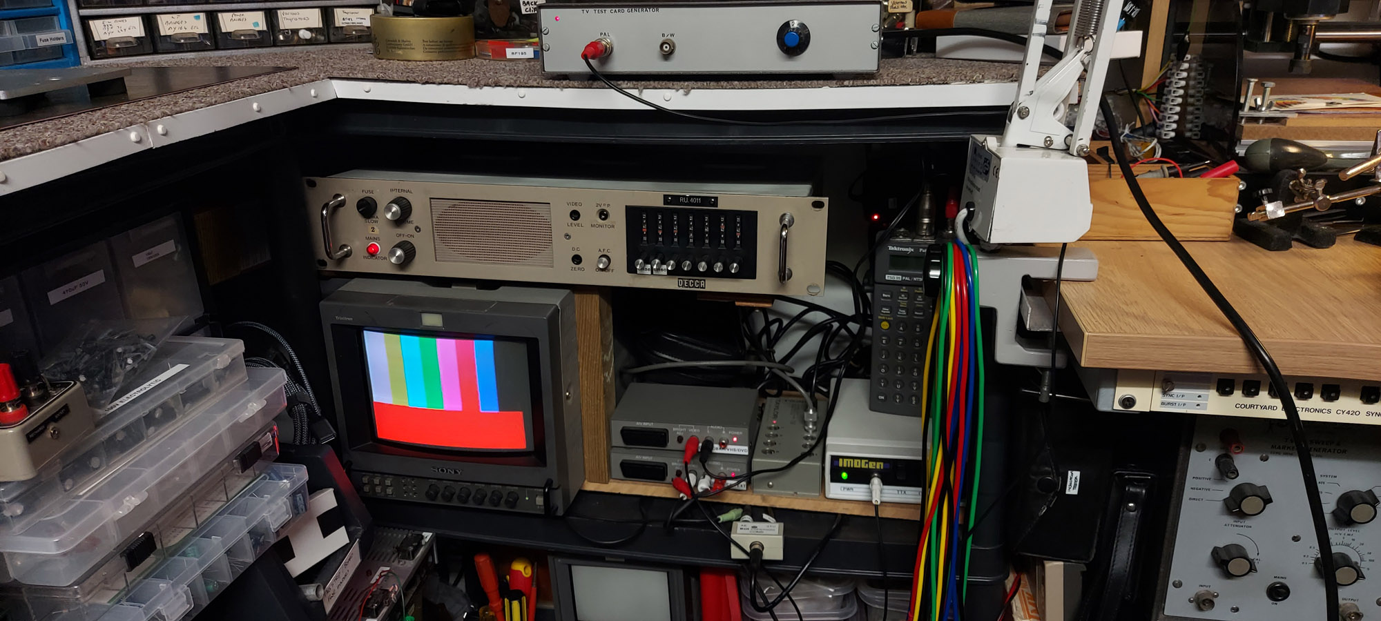

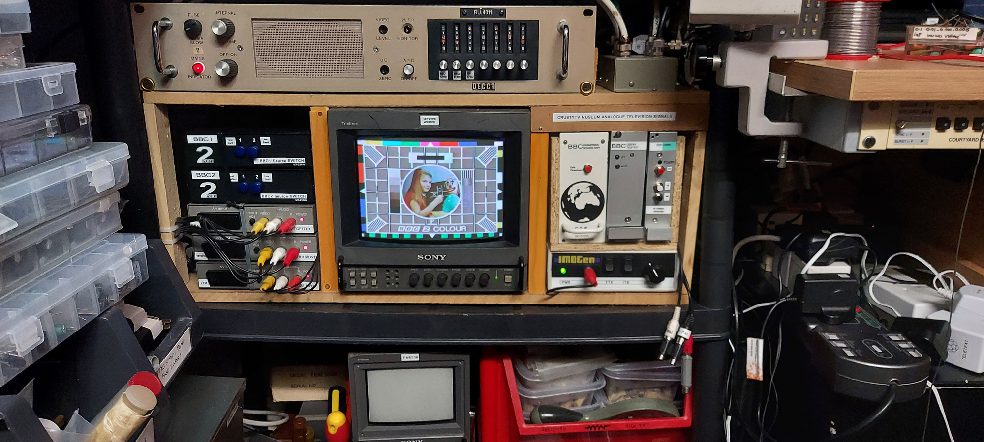

To provide context to all this, I have a private museum with around 50 vintage colour televisions, ranging from the first generation 1967 colour dual-standards (Baird 700 series, Thorn 2000, DECCA Battersea) all the way up to KT30 & TX100, with everything in between, 697, A823, T20A Thorn 3000,3500, 4000, 8000, 8500, 9000, TX9, TX10, TX100. Plenty of continentals too and a myriad of video from N1500, N1700 all the way up to V2000, VHS and Beta, 70s to mid 80s.

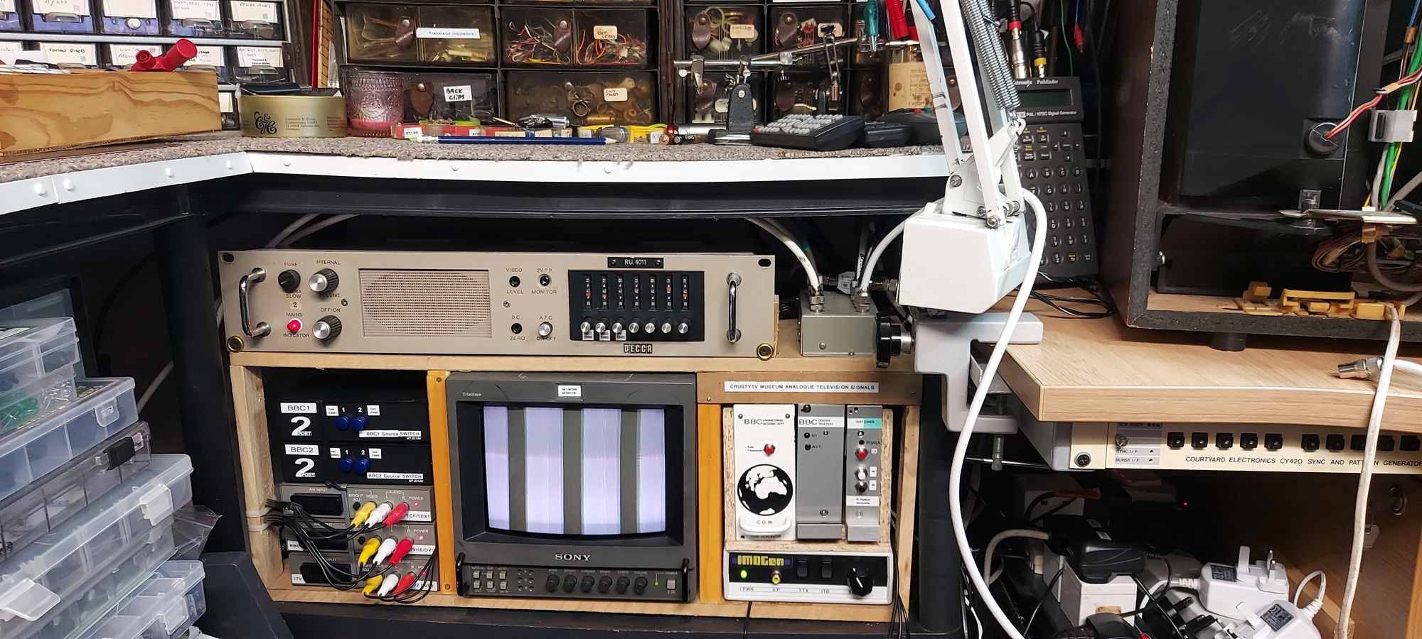

To supply all these TVs when they are repaired with signals, I built an analogue TV network for the museum. Three channels BBC1, BBC2 & ITV, these can be switched to test signals or vintage programme feeds from DVD/VHS period material. For the test signals, I have a Test Card F generator which also produced 15-pages of teletext and a B&W 625-line BBC2 card.
Then I have a BBC C.O.W generator, pattern generator with many cards such as J, PM5544, F, CH4 etc and finally a Teletext module which provide live up-to-date news via a replica Ceefax service, these are using Raspberry Pi. The COW is actually built into a BBC rack module that used to provide tone for open university.
The DECCA RU.4011 monitors the RF system and allows me to select the channels and display via the SONY PVM and monitor audio via its onboard speaker.
It's in a temporary wooded rack constructed from what was around, the plan is to get it all nicely housed in a proper unit as and when time permits.

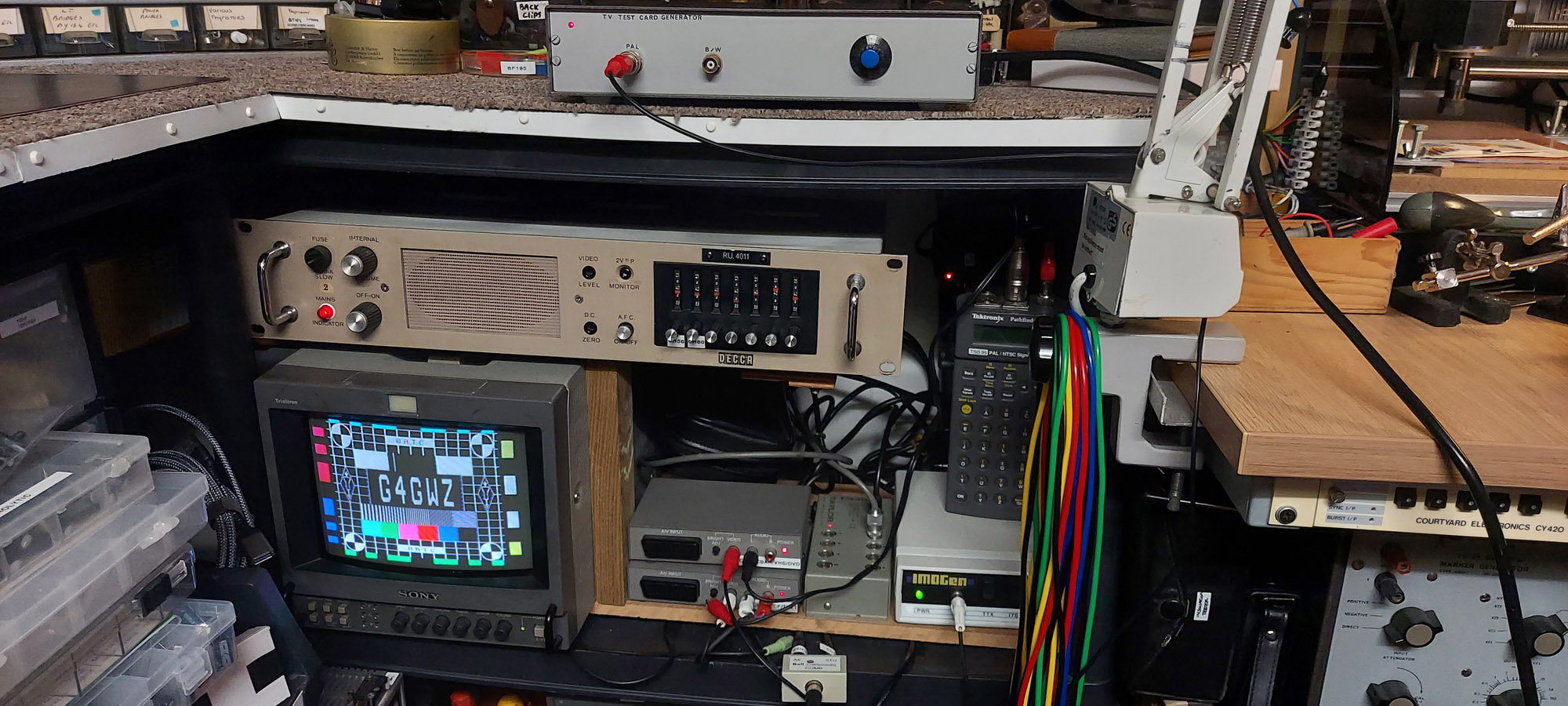

Getting to the point of this post, the B.A.T.C will be joining the rack to provide test signals for a 4th channel, hence wanting to extend its test card range.
Hope that was of some interest.

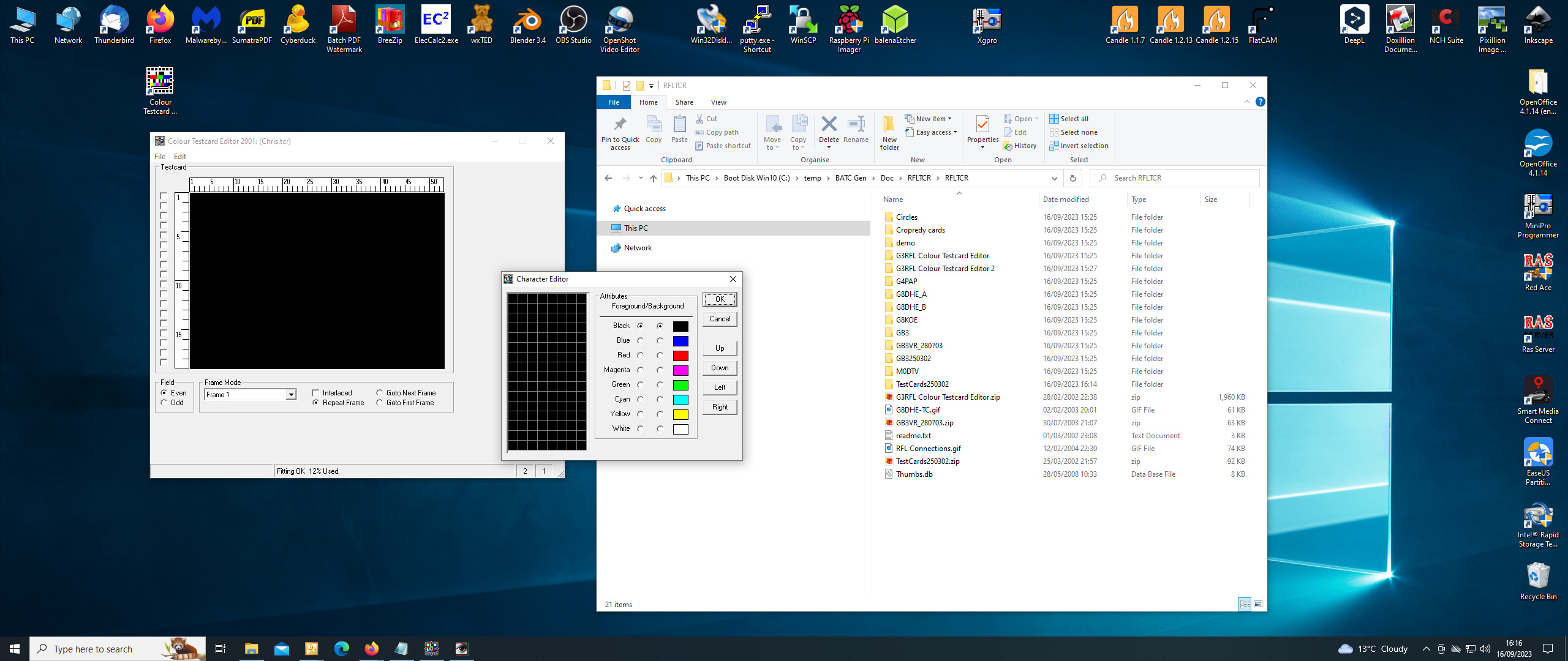

An update to this, as previously mentioned I had recently bought one of the EPROM programmers the T56 which is the upgrade from the TL866 and as such supports lots more chips and can write at the higher 25V. I recently removed the BATC EPROMS that held the four test cards, read them and importantly backed them up as .BIN files.

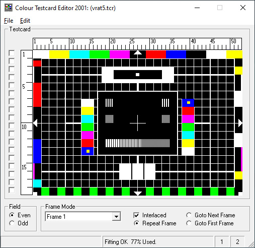

This evening, I tried to import the .BIN, but the software expects a .tcp or .tcg file. I then copied the .BIN file renaming the extension to .tcg and hey presto the test card appeared in the software.
This is all working out rather nicely, one question to those that might know the answer. Why does the software editor palette not support grey? This is the one colour I would dearly have liked. Especially for performing a grey-scale, surely back in the day members must have wanted it too.

Having problems with this. I've created a test card (see below) but when I blow a new EPROM and install it into the generator, it does not display the test card, just a few fat white bars pulsing on the screen.

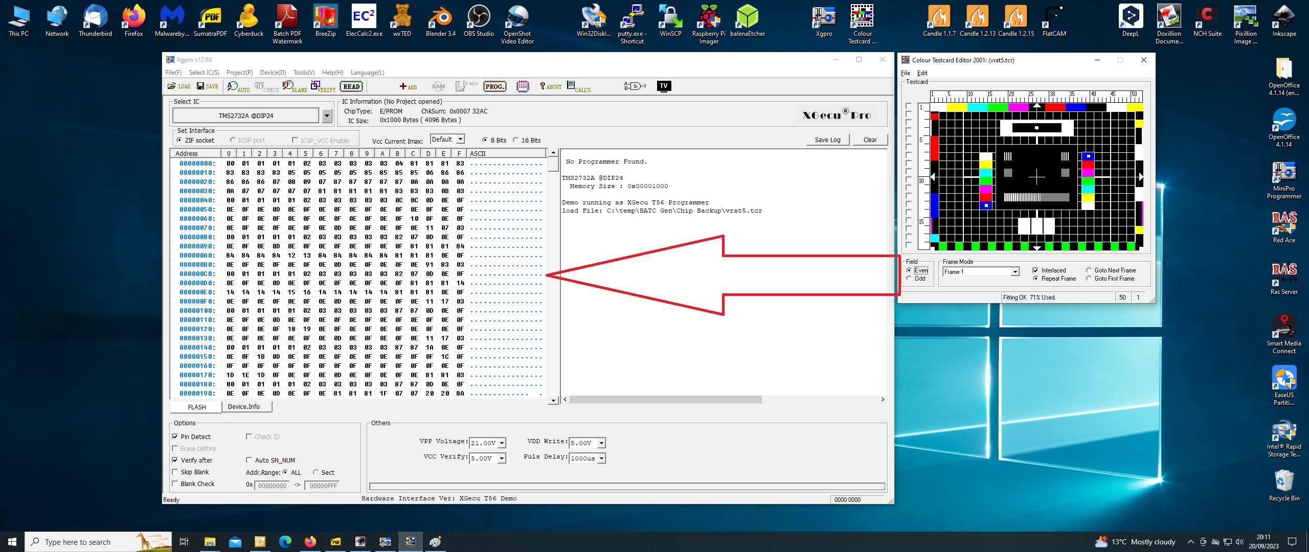

To prove the EPROM burner and the EPROMS I have, I read one of the original installed chips and saved it to a .BIN file. I then took the file and blew a copy EPROM, installed it into the generator, it displayed the contents just fine.
I then thought, OK, maybe there's something I did when creating my test card. So I looked in the folders I was given with the software and found some test cards created by others. I took one of the .tcr files, loaded that into the burn software, it loaded in the data, and then I blew a new chip. It passed OK. I then installed this EPROM in the generator, same scenario, flashing bars.
I then exported the .tcr test card file as a .BIN file, blew another chip, same scenario.
The only conclusion I can come to, perhaps mistakenly, is the Colour Test card software is not producing output that is compatible with the T48 Burner despite it appearing to be.
