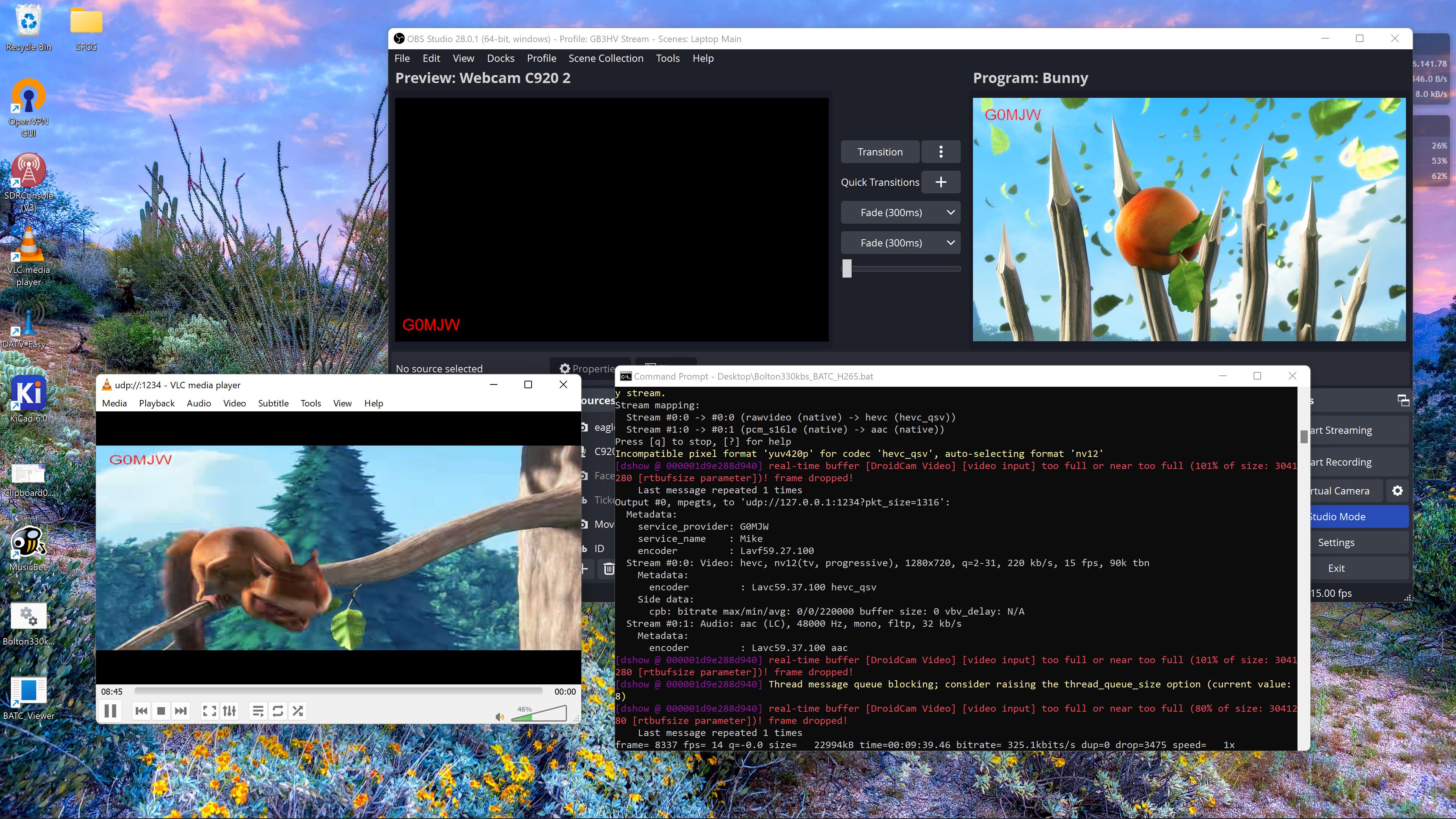

I have discovered a possible solution in DroidCam.https://github.com/dev47apps/droidcam-o ... ual-output
I didn't have my Nvidia PC to hand to test this so I am using hevc_qsv, the intel codec build into modern CPUs. It seems to be working fine with the intel codec on my laptop.
Note I have no idea what the optimum settings might be for the intel vs nvidia. I doubt it is as good but it comes for free. I just used the same ones which isn't likely to be right but surprisingly works.
c:\ffmpeg\bin\ffmpeg -f dshow -i video="DroidCam Video" -thread_queue_size 512 -f dshow -i audio="Microphone (DroidCam Audio)" -vcodec hevc_qsv -s 1280x720 -bf 0 -pix_fmt yuv420p -b:v 220k -r 15 -preset slow -profile:v main -rc cbr_hq -rc-lookahead 5 -acodec aac -aac_coder twoloop -ar 48000 -ac 1 -b:a 32k -f mpegts -muxrate 325k -streamid 0:256 -streamid 1:257 -metadata service_provider="G0MJW" -metadata service_name="Mike" -max_delay 2500000 -pcr_period 40 -pat_period 0.4 "udp://127.0.0.1:1234?pkt_size=1316"

With a bit more thinking about it this worked better with the intel encoder, having removed some of the nvidia specific switches and also got the aspect ratio and resolution right.
c:\ffmpeg\bin\ffmpeg -f dshow -video_size 1280x720 -rtbufsize 100M -i video="DroidCam Video" -thread_queue_size 512 -f dshow -i audio="Microphone (DroidCam Audio)" -vcodec hevc_qsv -bf 0 -pix_fmt nv12 -b:v 220k -r 15 -preset slow -profile:v main -acodec aac -aac_coder twoloop -ar 48000 -ac 1 -b:a 32k -f mpegts -muxrate 325k -streamid 0:256 -streamid 1:257 -metadata service_provider="G0MJW" -metadata service_name="Mike" -max_delay 2500000 -pcr_period 40 -pat_period 0.4 "udp://127.0.0.1:1234?pkt_size=1316"
The bit -f dshow -video_size 1280x720 -rtbufsize 100M -i video="DroidCam Video" -thread_queue_size 512 -f dshow -i audio="Microphone (DroidCam Audio)"
and -pix_fmt nv12 covers the different input compared to virtualcam.
I experimented with the -rtbufsize figure, 100M seemed enough, it might be too much but most people have plenty of RAM. Increase it if not enough
