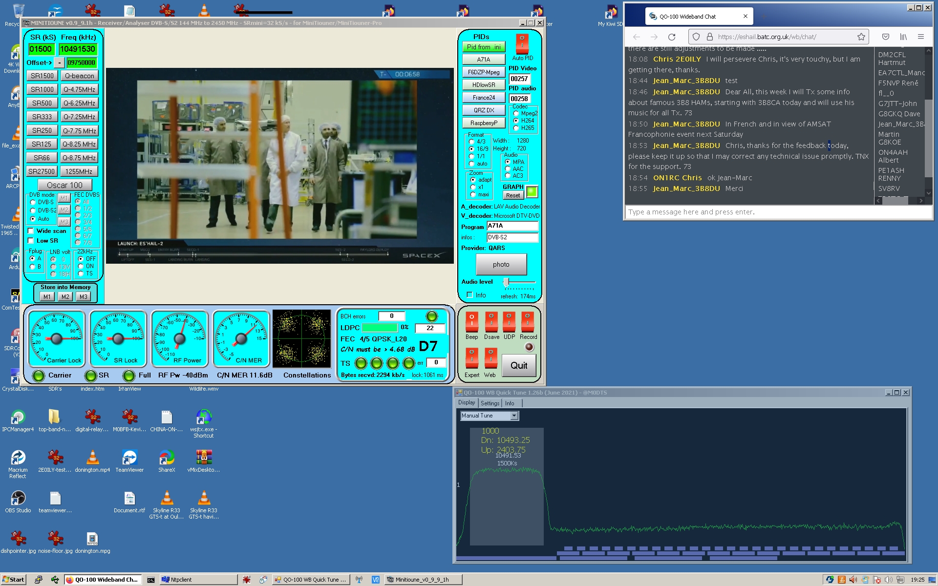

I was initially able to see my tone and tune signals from SDR Console on Goonhilly and they looked fine. I then tried to send a test card from my PD4 and watched for the signal on both my MiniTiouner and on the web quick tune software. I was alarmed to see 2 seconds of a normal signal then it broke up and showed not as 333 kS/s but as 1500 and then 2000 at a low level. I didn't want to spend long sending iffy signals, but using 250 kS/s did the same. 2 seconds of OK, then break up and bizarre signals being received both here and at Goonhilly on the Quick Tune display.

Here are screenshots of what to me looks like the initial two seconds of OK signal, then one of the less spattery bizarre changes after two seconds. Reducing input power to the Pluto from 0 dBm to -15 resulted in no signal received here or at Goonhilly.
